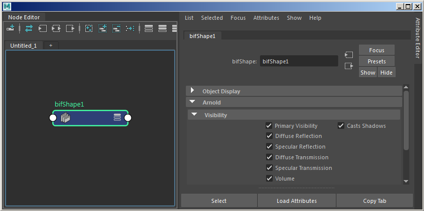

Arnold visibility attributes found under the bifShape node

When a shader is overridden, e.g. a shader is applied to the bifShape or bifrostGraphShape in Maya, it gets applied to all of the Arnold shapes generated by arnold_bifrost. However, if the shader to be applied is not a volume shader, it should not apply it to volumes so that in-graph volume shaders still get applied (or the default generic volume shader that arnold_bifrost generates gets applied). If you create your own custom volume shader and assign it directly to the bifShape or bifrostGraphShape, arnold_bifrost will not recognize it. The solution, in that case, is to just apply the custom shader in-graph.

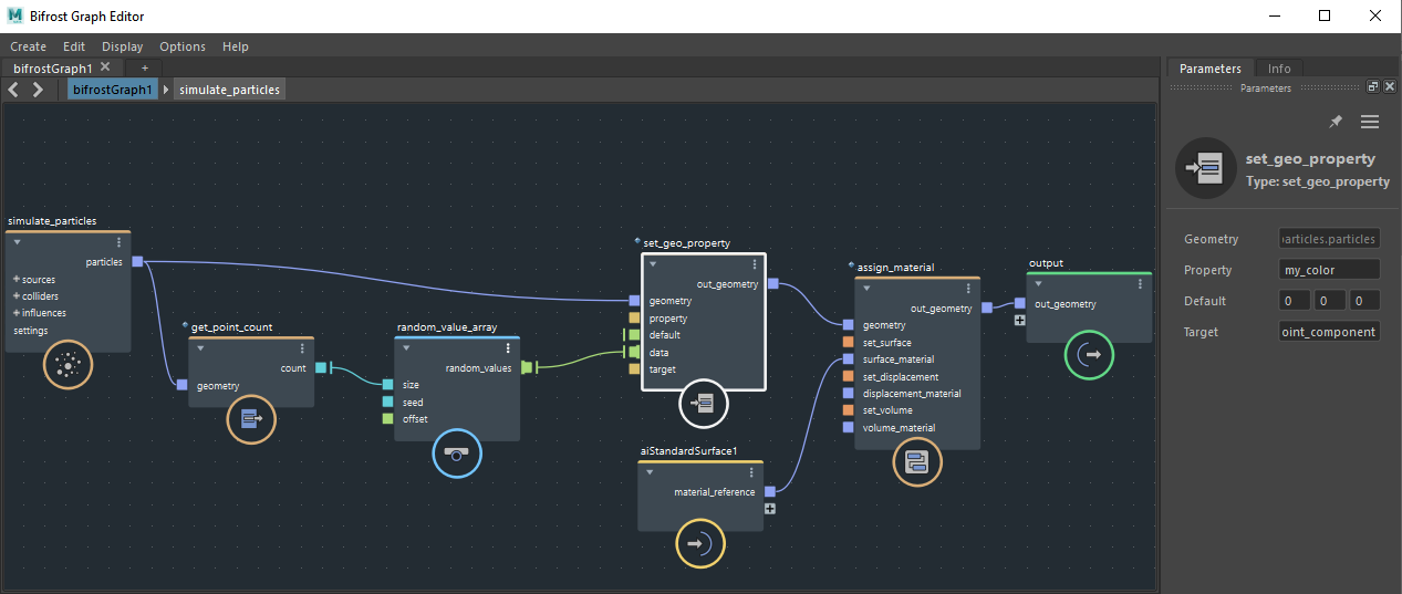

Randomize Particle Color Workflow
Below is an example of how to randomize the color of Bifrost particles.
| A scene file can be downloaded here. |
random_value_array -> new set_geo_property (color). The color is a float3 or float4 property (RGB, RGBA).
