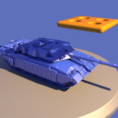

The tank in this example is invisible to camera rays but visible to all other types of rays, including shadow rays

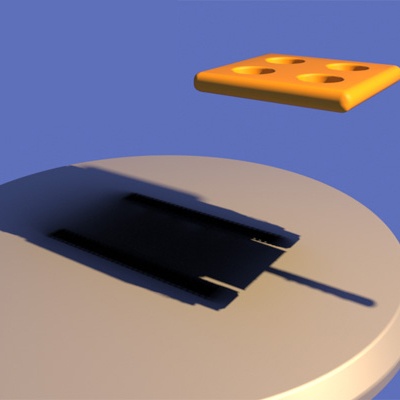

Casts Shadows
Determines whether the object casts shadows.

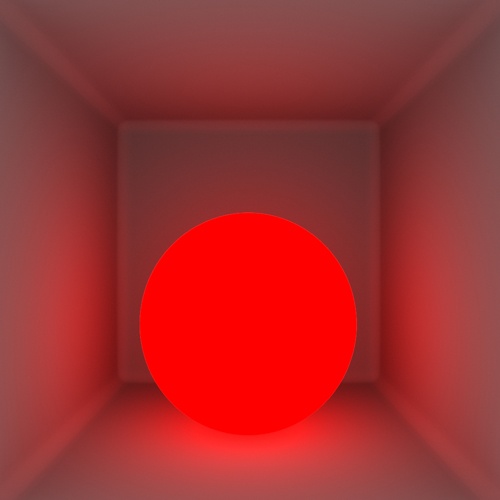

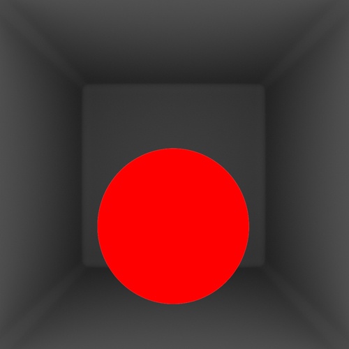

Diffuse Reflection
Affects indirect diffuse rays (i.e., global illumination, hemi, or GI rays).
| Sphere has visible_in_diffuse enabled | Sphere has visible_in_diffuse disabled |

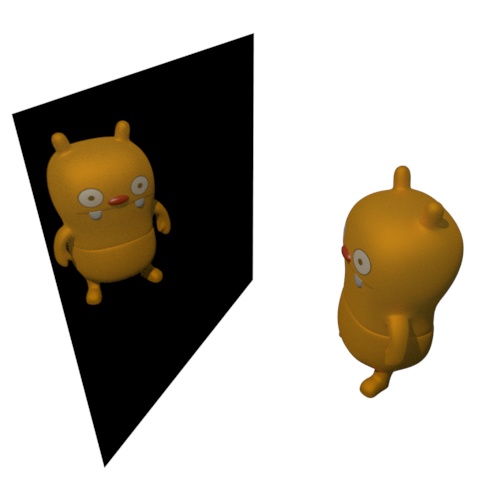

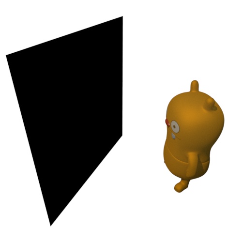

Specular Reflection
You can selectively disable an object's visibility for the various types of rays in the renderer. By default, objects are visible to all types of rays. Specular Reflection visibility affects indirect specular rays (i.e., specular reflection rays).
| Enabled | Disabled |

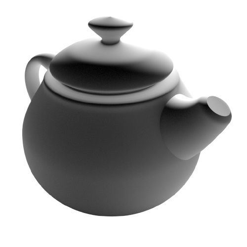

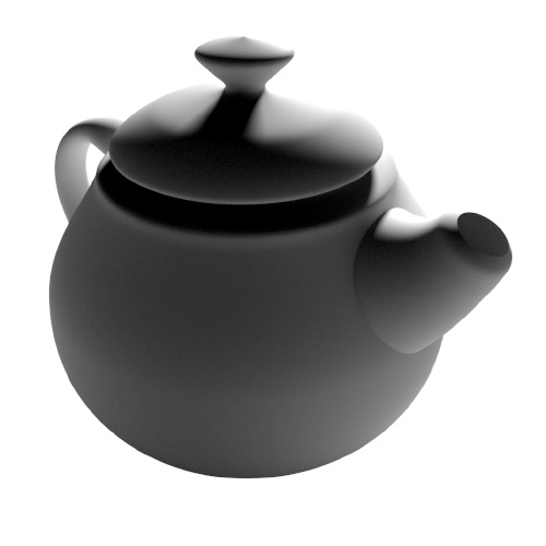

Self Shadows
Determines whether or not the object casts shadows on itself.
| Disabled | Enabled |
