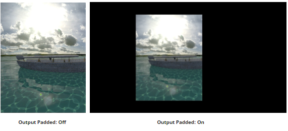

Output Padded
Defines a padding around the crop region.
