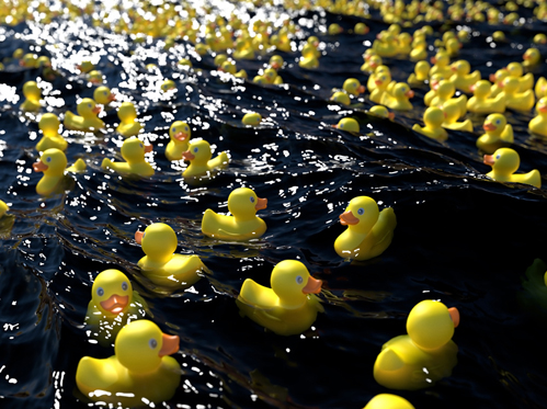

Duck model exported as .ass file and imported as a procedural
You can export any object as a .ass file. A procedural (also called stand-in, proxy or placeholder) references the .ass file on disk (or other procedural formats supported by Arnold such as .obj or .ply). They allow you to keep your working scene light and workable by deferring the loading of geometry data until render time.

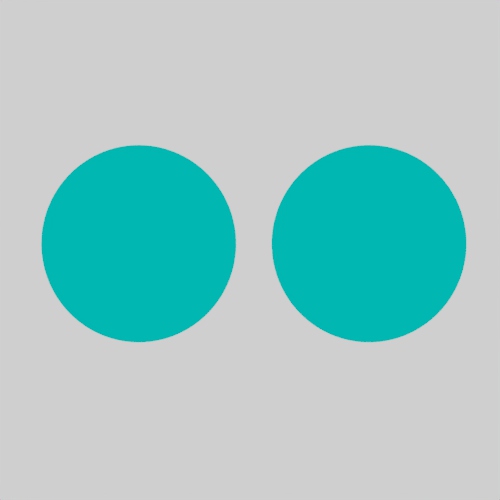

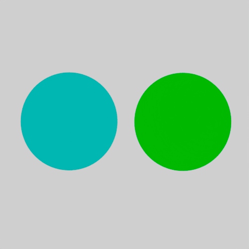

The utility shader's object mode does not work with procedurals (stand-ins). This is a known limitation. The color of the spheres changes when the utility shader's mode is object. However, the procedural color remains the same.
Spheres Arnold Procedural
