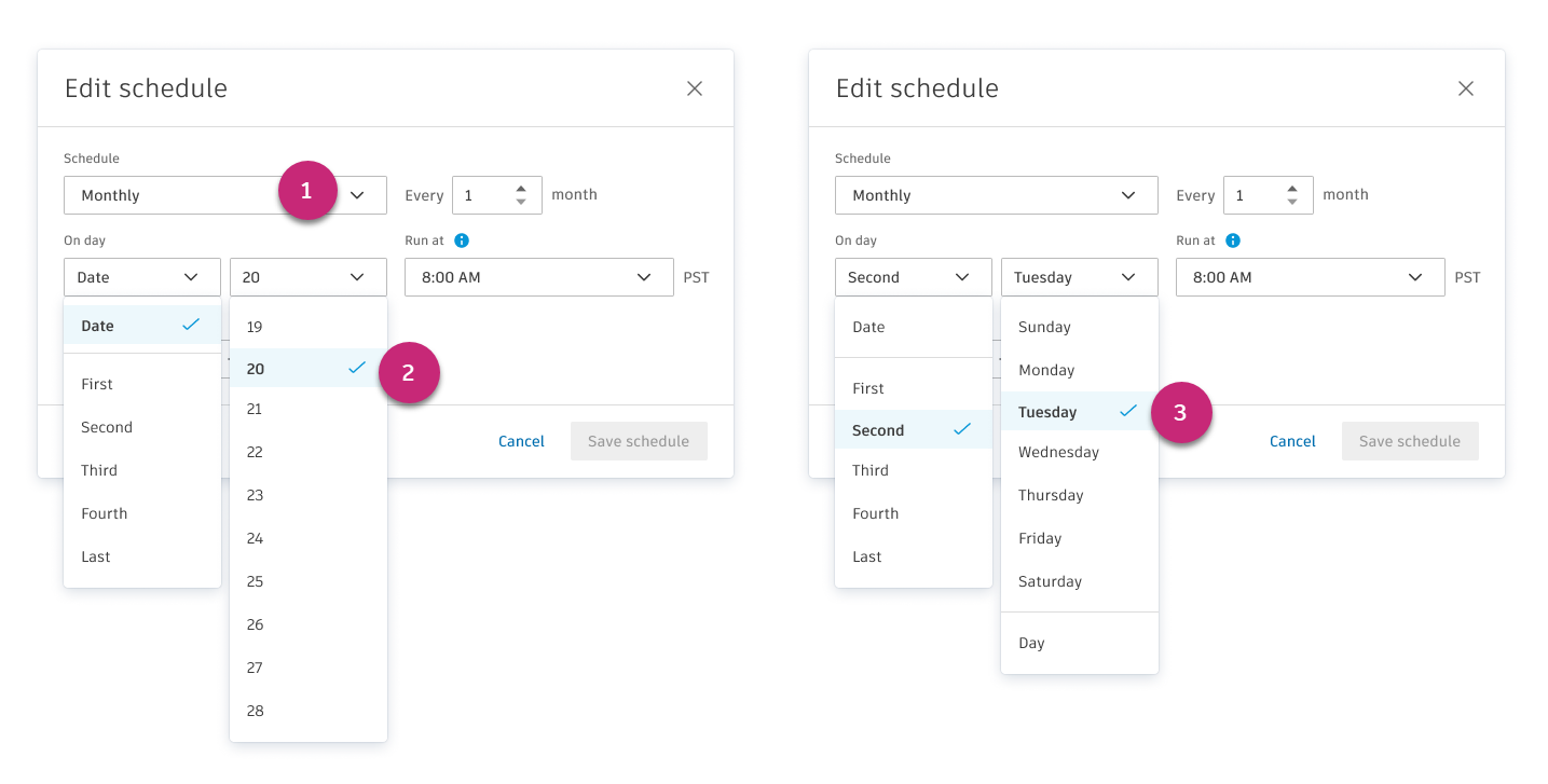

Schedule Budget Snapshots
Set up automatic snapshots to capture budget data at regular intervals. You can configure the frequency, day, time, and duration for which snapshots should be taken:
  1. Choose between weekly or monthly snapshots.
  2. Specify the day of the week for weekly snapshots. For monthly schedules, snapshots occur only once per month.
  3. For monthly schedules, define the specific instance of the day within the month (for example, first, second, or last). The default value is first. For example, selecting second Tuesday schedules the snapshot for the second Tuesday of each month.
Budget snapshot setting
When configuring snapshots, you’ll receive an estimate of how many snapshots will be generated within the specified time frame.
Note: Only one budget snapshot schedule can be active at a time.
To delete a schedule, click Edit schedule, and then select Remove schedule.
Snapshots are accessible in the Budget tool, where you can filter between manually and automatically created snapshots.Learn more about Budget Snapshots.

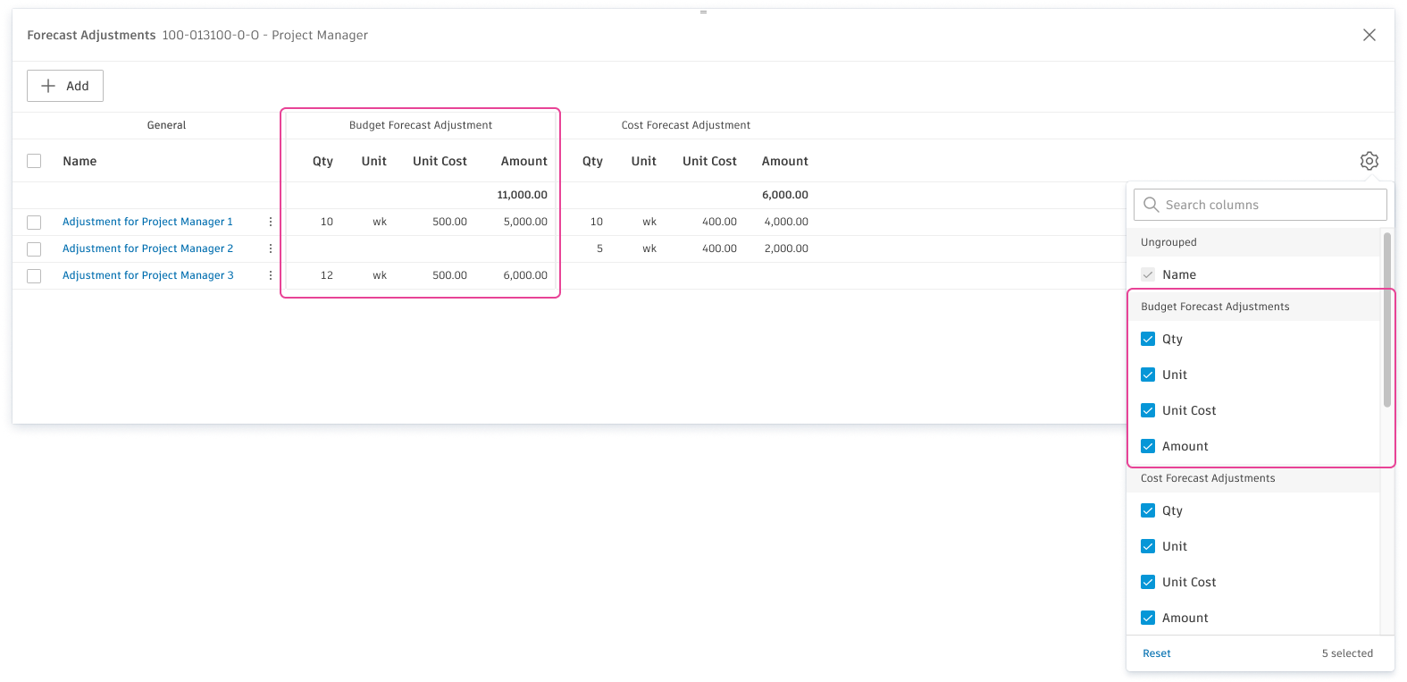

  • Columns Billed To Date, Budget Forecast Adjustments, Forecast Budget To Complete, and Forecast Final Budget are visible by default in the budget overview.
  • Budget forecast adjustment columns Qty, Unit, Unit Cost, and Amount are visible by default in the budget overview and forecast adjustment bottom flyout.
    Budget Forecast Adjustments Forecast
  • Budget forecast columns in date range resources are visible by default. See Date Range Based Resources to learn how to configure the frequency settings.

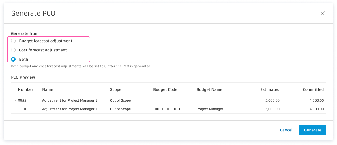

  • You can generate a PCO from budget and forecast adjustments and make budget transfers.
    Generate a PCO from forecast adjustments
Note: This setting cannot be turned off once Forecast Final Budget is selected as the distribution curve in the cash flow settings. See Forecast Settings to learn more.

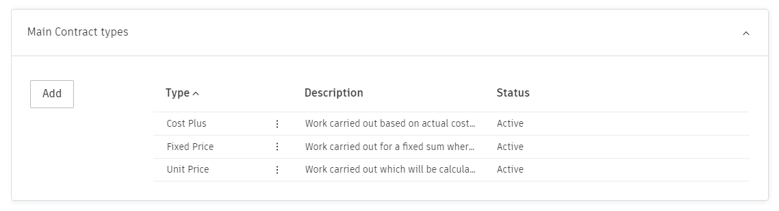

Main Contract Types
A main contract is the primary contractual agreement entered into directly, for example, between an owner and a main contractor. When creating a new main contract, you can choose your main contract type from the predefined options or add one in the settings to fit your company's needs.
Choose from the presented options:
  • Cost Plus - Work carried out based on actual cost plus additions as but not limited to overheads and profit.
  • Fixed Price - Work carried out for a fixed sum where actual costs incurred may differ from the incoming value paid. If you choose this option, markup cost item values will be spread over normal cost items in approved owner changes. Learn more about spreading markup budget values. When you choose this option as the main contract type, any additional costs added to change orders will be hidden from the client. This means that if you add a 10% markup to a $10,000 concrete works change item, the client will only see the final cost of $11,000 for the concrete works item on their invoice.
  • Unit Price - Work carried out which will be calculated based on detailed measurement of task progress.
Tip: System defaults cannot be deleted. You can deactivate them, so they do not show up in the user interface.
To add a new main contract type, click Add in the upper left corner of the Main Contract Types.

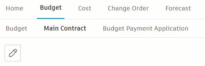

To assign a contract type to a line item by a drop-down list, enter the edit mode Pencil edit icon in the Main Contract tab.
Edit main contract interface showing contract type assignment in dropdown
