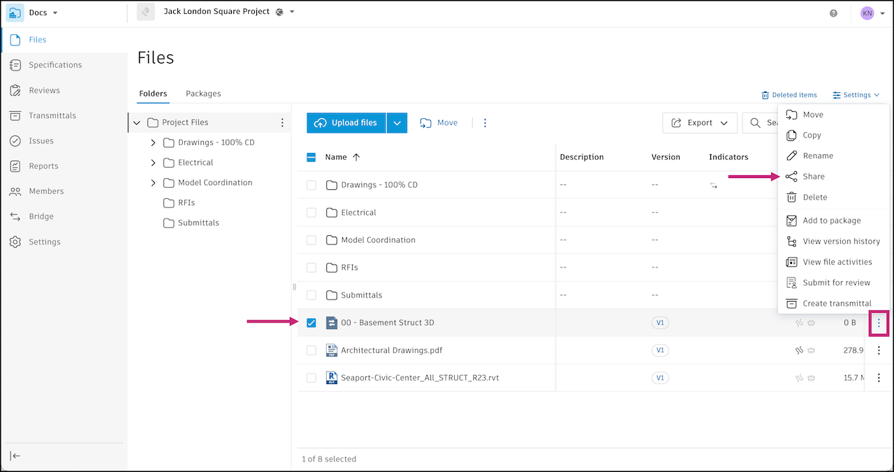

  1. In the Files tool, find your Data Exchange file or create a Data Exchange. Your Data Exchange will display on web with a FDX icon icon.
  2. Select the Data Exchange or the folder where the file is located. Click the More menu More menu icon at the top or next to the Data Exchange file or folder.
  3. Select Share.

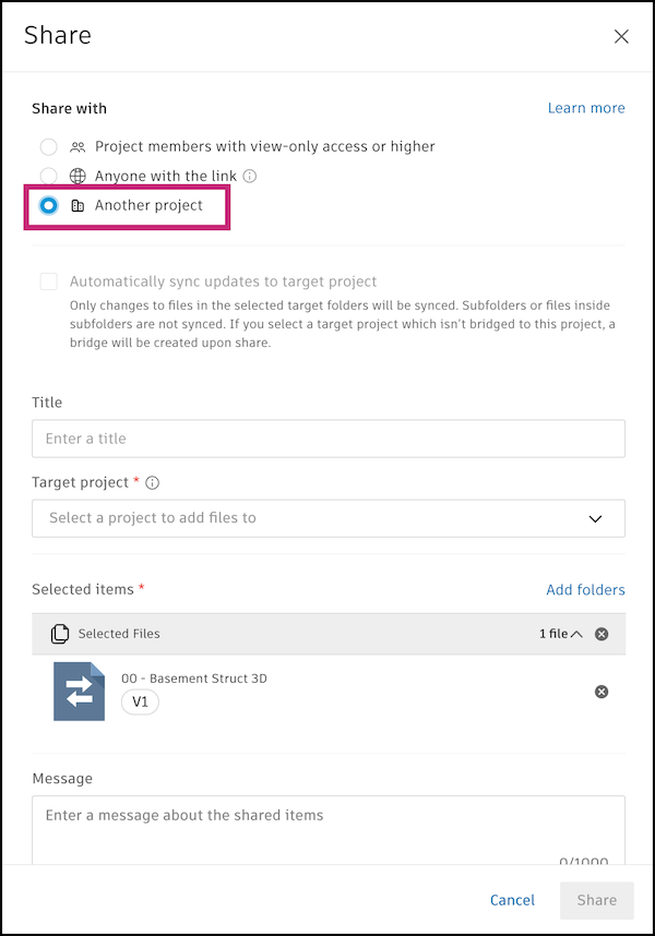

  4. Under Share with, select Another project.
    Share data exchange
  5. If you selected to share a folder with a Data Exchange inside, you could set up an automation where any updates to the folder will automatically sync to the project you are sharing with. This is not available for individual files.
    Note: However, whether you can choose to automatically sync or not, once shared, new versions of a Data Exchange file will typically be automatically synced to the target project. So you don't need to do any manual work for your team to receive the most up-to-date Data Exchanges.
    Learn more about the limitations and what happens to Data Exchanges in various scenarios when shared through Bridge.
  6. (Optional) Enter a title. This will identify the items you have shared when you manage this in the Bridge tool.
  7. Select the project and folder (if available) that you want to share the Data Exchange with.
    Note: If you select a bridged project, you won't be asked to select a folder. The project administrators in the target project will review and approve what you are sharing and where it gets saved to in their project.
  8. Review the items that you will be sharing. Click Add folders to add other folders you want to share or click Remove icon next to any items you no longer want to share.
  9. Click Share.

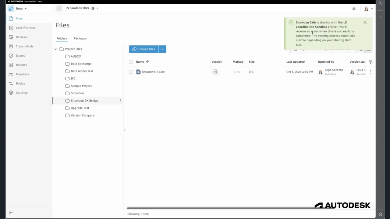

  10. In the Bridge tool, you can track the Data Exchange that was shared in the Outgoing tab. If you receive any data exchanges, you can track them in the Incoming tab. Learn more about the Outgoing tab and the Incoming tab
