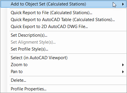

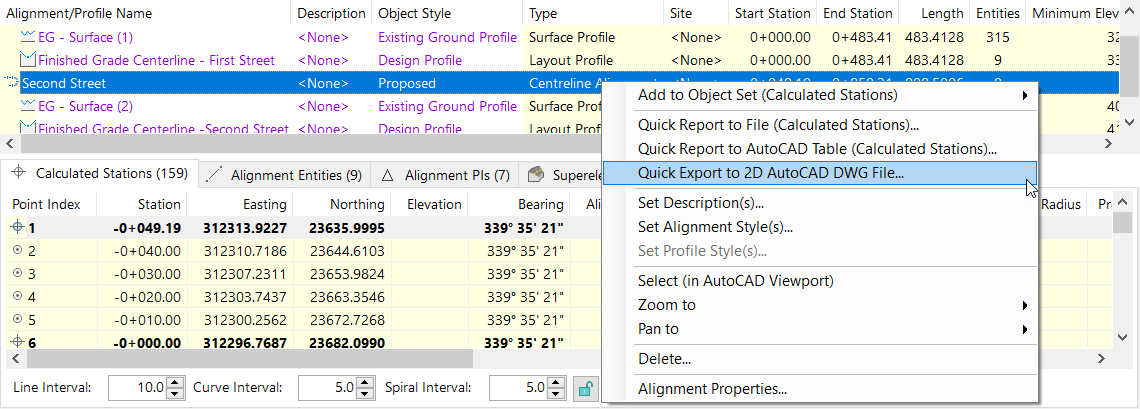

Quick Export to 2D AutoCAD DWG
To use the Quick Export to 2D AutoCAD DWG option, select one or more objects from any object list pane in the Project Explorer window and select the "Quick Export to 2D AutoCAD DWG" option from the right-click menu.
