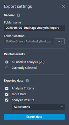

Use the Export data tool to save your analysis result data as a *.xlsx file.
At the top right of the Analysis Results page, click export Export data.
The Export settings panel opens.
analysis results export settings
  • Under General, specify a folder name and location for the exported files.
  • Under Rainfall events, select which rainfall events to be exported with the analysis data. Each event will create a new *xlsx file.
    • All used in analysis will export every rainfall event used by the analysis. The total number of rainfall events is shown in parentheses.
    • Currently selected will export the Rainfall Event specified at the top of Analysis Results.
  • Under Exported data, specify what data to include in the exported results. This data appears as sheets in the created *.xlsx file.
    • Analysis Criteria includes rainfall analysis criteria used for the analysis: Rqainfall Type, Rainfall Set, Rainfall Event, Duration, and Run time.
    • Input Data includes all Time Area Runoff data in the analysis.
    • Analysis Results includes all results:
      • Drainage System Results (totals)
      • Connection Results
      • Catchment Results
      • Structure Results
      • Stormwater Control Results
Click Export data to generate the files.
