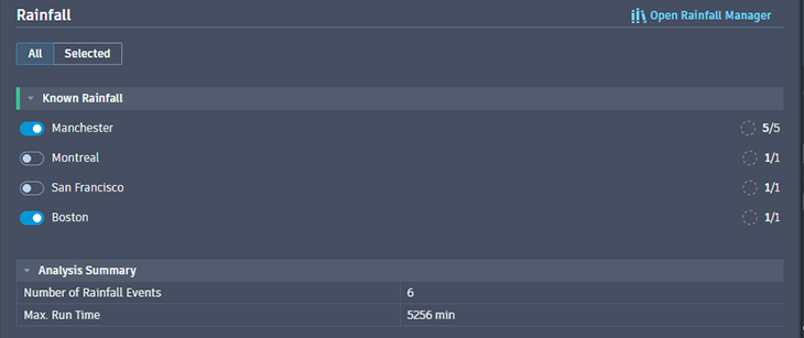

Under the Rainfall section, select one or more Rainfall Sets to apply to the drainage system.
The counts to the right of the Rainfall Sets represent the total number of events selected out of the possible number of events in the set. The Analysis Summary at the bottom displays the total number of Rainfall events applied to the drainage system and the largest specified maximum run time of the events.

Use the Rainfall Manager to select fewer or specific events in a Rainfall Set.
  1. Click Open Rainfall Manager.
  2. In the Rainfall List, select the Rainfall Set containing the desired Rainfall Events.
  3. Select Use in Analysis for those events to be selected with the set.
  4. Click Save Changes.
  5. Close the Rainfall Manager.
Notice the selected counts have changed, as has the Analysis Summary.
