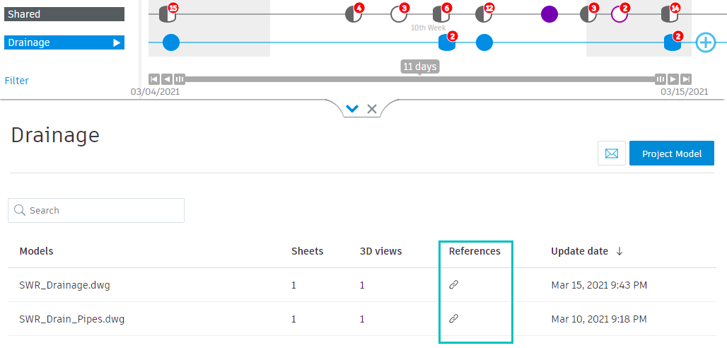

When DWG files have been uploaded to team folders in Docs, they are displayed in the corresponding team space in the Home tool in Design Collaboration.
Files that have XREFs have an icon displayed in the References column:
Tip: The icon is only visible if you are a member of the team, or if the reference has been consumed by your team.

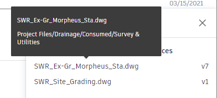

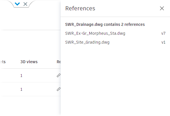

  1. Click the References icon to open the References panel, which displays the names and versions of the referenced files:
  2. Hover your cursor over a referenced file to see its folder location:
