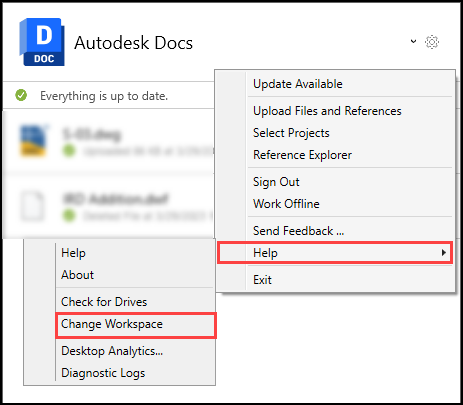

  1. Click the Desktop Connector tray icon Desktop Connector Tray Icon to open the home screen.
  2. Click the gear icon Desktop Connector Tray Icon and select Help > Change Workspace from the menu.
    Change Workspace Help Topic

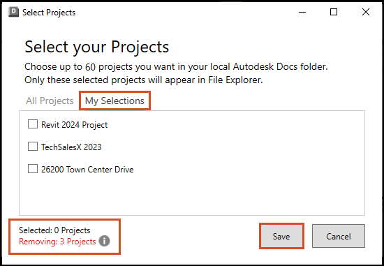

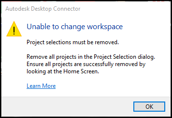

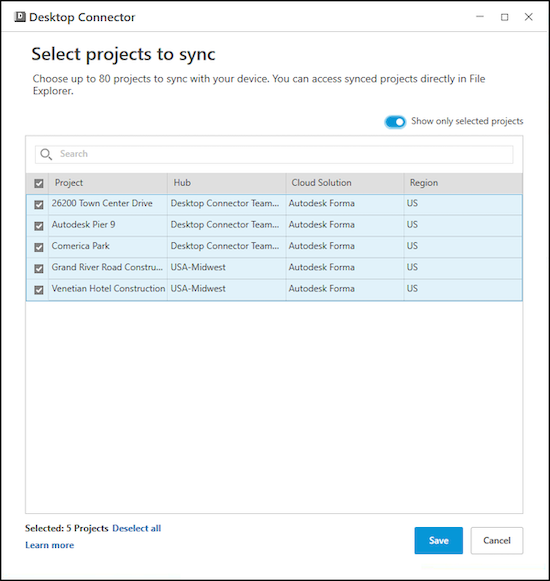

  3. If you have NOT deselected your projects you will receive the following warning.
    Unable to Change Workspace
    Deselect your projects continue to Step 4 and resume the Change Workspace procedure.

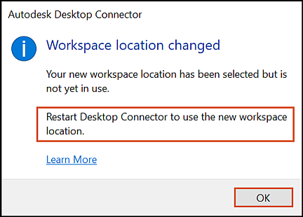

  4. Select your new workspace location in line with the Change Workspace Requirements which will then show a dialog box to confirm that your workspace location has changed.
    Initiate Change Workspace
  5. Restart Desktop Connector.
After restarting, Desktop Connector will verify that the Change Workspace Requirements are met before using the new workspace.
