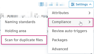

Access Scan Settings
Project administrators can access the duplicate file scan settings in Autodesk Docs.
Click the Files tool.
Click Settings.
Hover over Compliance.
Click Scan for duplicate files.
