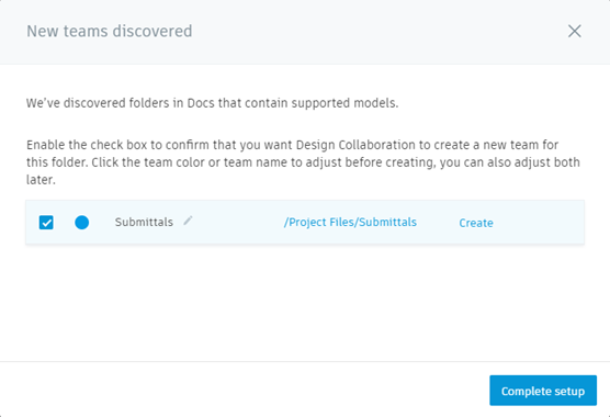

Click the link in either the Project Admin module or in the banner notification to open a dialog box box in the Project Admin module. This allows you to specify how the teams should be set up.
- Click the checkbox next to the color and name to create a team for that folder.
- Click the color and select a new color for the team to appear on the timeline in Design Collaboration.
- Click into the folder name to adjust the team name and click the check mark icon to save the new name.
- Click Complete setup to create the team.
