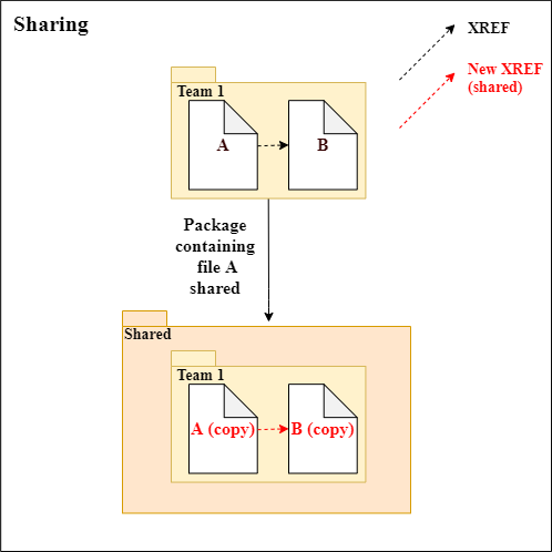

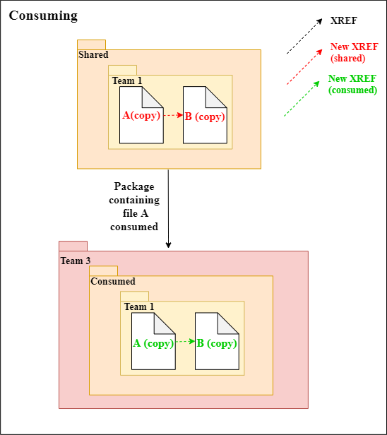

Use Case 1
Scenario
You work in Team 1. Files A and B are both in your team folder. File A references file B. You share a package containing file A.
Results
Sharing: Files A and B are copied to the Shared > Team 1 folder, and an XREF is created between the copies.
Consuming: When Team 3 consumes the package, files A and B are copied to the Team 3 > Consumed > Team 1 folder, and an XREF is created between the copies.

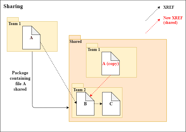

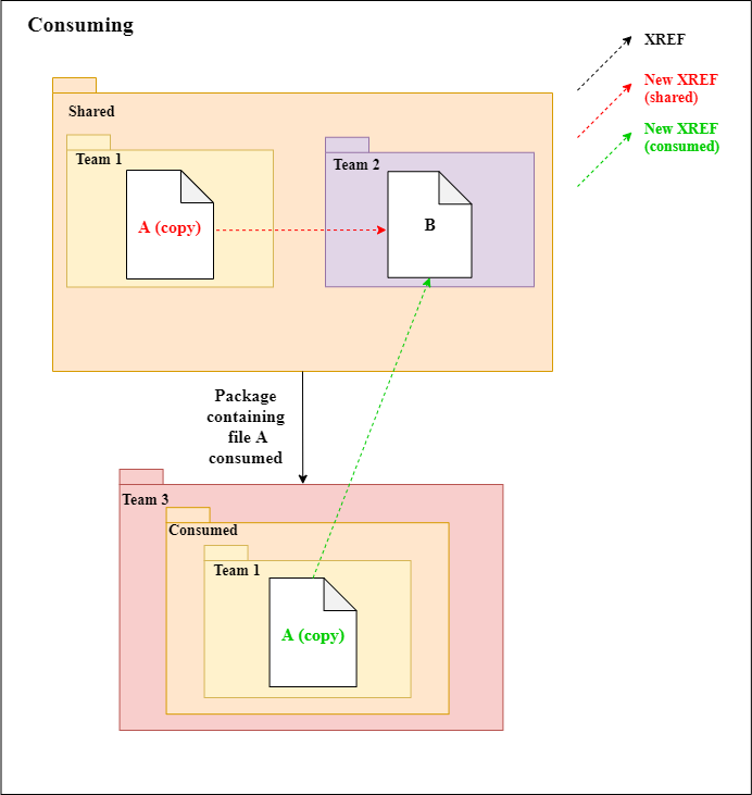

Use Case 2
Scenario
You work in Team 1. File A is in your team folder, and file B is in the Shared > Team 2 folder. File A references file B. You share a package containing file A.
Results
Sharing: File A is copied to the Shared > Team 1 folder, and an XREF is created between the copy of file A and the original file B.
Consuming: When Team 3 consumes the package, file A is copied to the Team 3 > Consumed > Team 1 folder, and an XREF is created between the copy and the original file B.

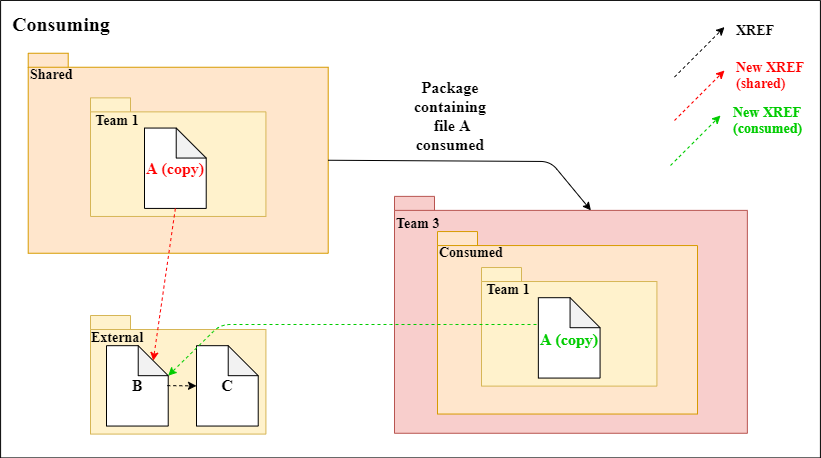

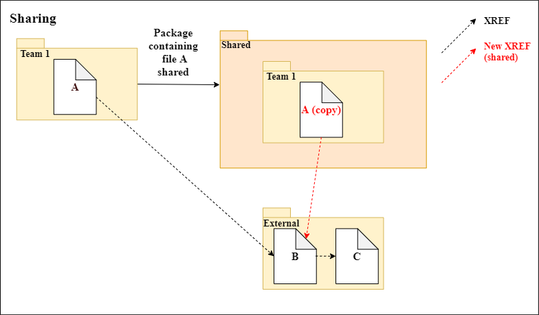

Use Case 3
Scenario
You work in Team 1. File A is in your team folder, and file B is in an external location. File A references file B. You share a package containing file A.
Results
Consuming: When Team 3 consumes the package, file A is copied to the Team 3 > Consumed > Team 1 folder, and an XREF is created between the copy of file A and the original file B.

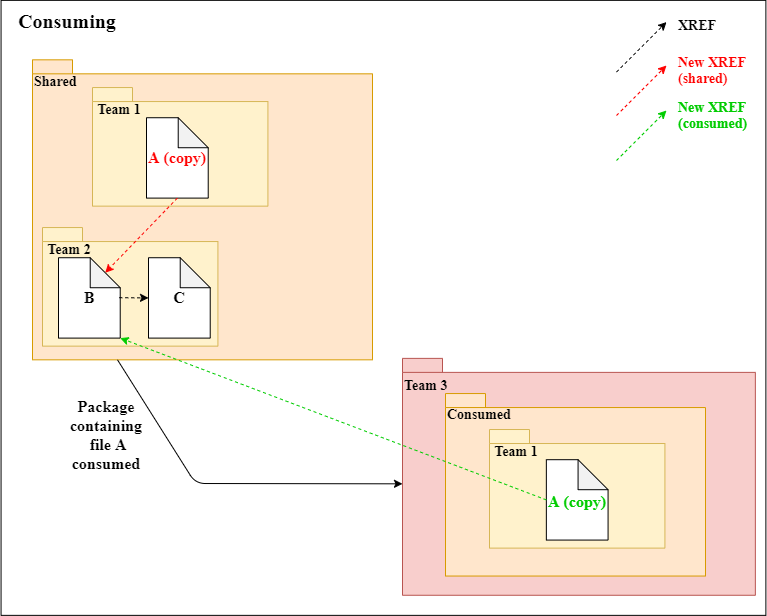

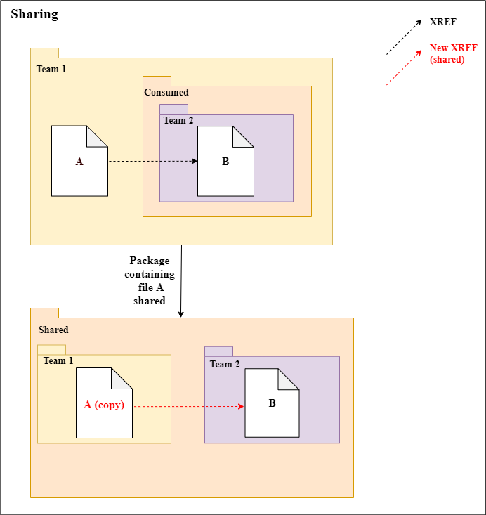

Use Case 4
Scenario
You work in Team 1. File A is in your team folder. File B is in your Team 1 > Consumed > Team 2 folder, meaning it was previously shared by team 2, and consumed by your team. File A references file B. You share a package containing file A.
Results
Sharing: File A is copied to the Shared > Team 1 folder, and an XREF is created between the copy of file A and the copy of file B that already exists in the Shared > Team 2 folder.
Consuming: When Team 3 consumes the package, file A is copied to the Team 3 > Consumed > Team 1 folder, and an XREF is created between the copy of file A, and the copy of file B in the Shared > Team 2 folder.
Note: XREFs always link to the latest available version of a file. In this scenario, the copy of file B in the Shared > Team 2 folder may be a more recent version than the one in the Team 1 > Consumed > Team 2 folder.

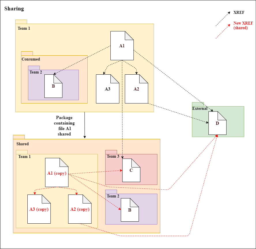

Use Case 5
Scenario

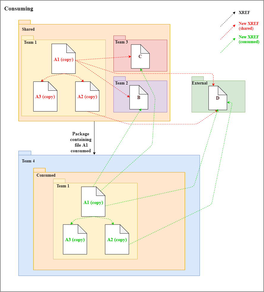

You work in Team 1. File A1 is in your team folder. File A1 references several files in different locations:
  • Files A2 and A3, which are also in your team folder.
  • File B which is in the Team 1 > Consumed > Team 2 folder.
  • File C, which is in the Shared > Team 3 folder.
  • File D, which is in an external location.
In addition, file A2 references file D. You share a package containing file A1.
Results
Sharing: Files A1, A2, and A3 are copied to the Shared > Team 1 folder. XREFs are created between the copy of A1 and:
  • the copies of A2 and A3.
  • The copy of file B that already exists in the Shared > Team 2 folder.
  • File C in the Shared > Team 3 folder.
  • File D in its external location.
An XREF is also created between the copy of file A2 and file D.
Consuming: When Team 4 consumes the package, files A1, A2, and A3 are copied to the Team 4 > Consumed > Team 1 folder. XREFs are created between the copy of file A1 and:
