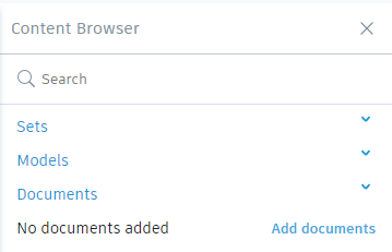

at the far right of the package timeline.Select the relevant sets and models from the content browser.
To add supporting documents to your package, select Documents from the content browser and click Add documents.
Select all relevant supporting documents from your team's folder. Refer to the Supporting Documents topic to learn more about the file types that can't be included as supporting documents.
Click Add.

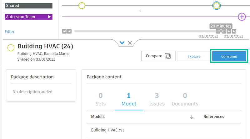

Expand the timeline, and click the node that represents the relevant unconsumed package.
Packages that have not been consumed are displayed as empty circles next to other team's lines on the timeline. They may look like any of the following examples:
Node type Description
An unconsumed package.
A mixture of consumed and unconsumed packages.
Multiple unconsumed packages.
A mixture of consumed and unconsumed models and packages. Tip: You may need to click the nodes that represent multiple packages several times until you have a single node selected.Click Consume to bring the deliverables into your team space.
If your Revit authors have linked into other team’s consumed online models, those Revit links are automatically updated in your team’s authoring environment. On the timeline, you’ll see that the package node on the Shared line is now filled to indicate that you’ve consumed it.
