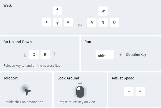

  5. Review the first person navigation controls and click in the whitespace to move to the project model.
    Tip: The navigation controls are presented each time you use the first person navigation. If you become familiar with the navigation controls, you may dismiss this message in the future.
Now you are placed into the project model in first person mode at the location and viewing angle selected from the 2D sheet. From here, you can walk around the model or quickly jump back to the previous view to return to the corresponding 2D sheet. While in first person mode, you can't select objects. Exit first person mode to make a selection.

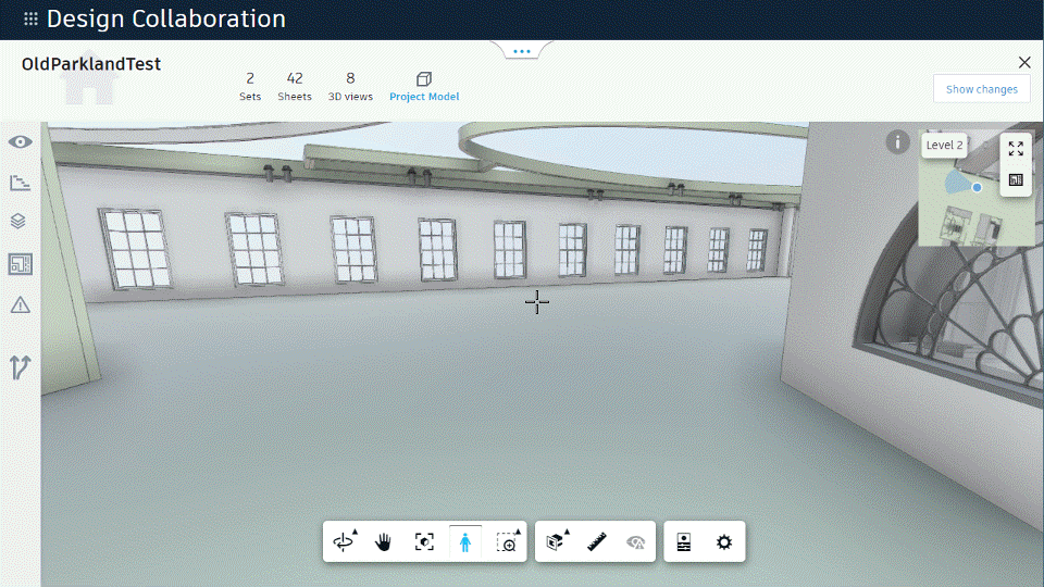

Mini-map
The mini-map feature provides a visual indication of your location and viewing angle within the scope of the model. To use this feature:
  1. In Design Collaboration, click Project Model.
  2. In the display toolbar at the bottom of the screen, click the First Person icon .
  3. Review the first person navigation controls and click in the whitespace to move to the project model.
    Tip: The navigation controls are presented each time you use this feature. If you become familiar with the navigation controls, you may dismiss this message in the future.
The mini-map is displayed in the top right corner of the screen. As you navigate in first person mode, your location and viewing angle is indicated in the mini-map, helping you to identify your location as it relates to the entire model. You can use the mini-map to navigate the model as well. To do so:
  1. Click and drag the icon in the mini-map to jump to another location in the model.
  2. Click and drag the viewing angle indicator to adjust the view in the display.
