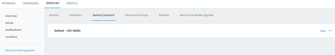

To access the naming standard settings:
  1. Switch to the Project Admin module.
  2. On the Services tab, click Document Management from the left panel.
  3. Click the Naming Standard tab.
There are a few ways to edit and apply a naming standard:
Apply Default - ISO 19650 Naming Standard

To apply this naming standard, click View then click Apply to apply.
