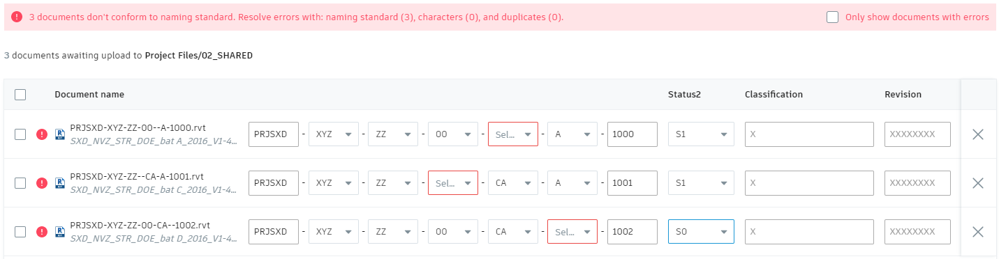

  3. Any errors that result from non-conformance with the naming standard are highlighted. Click into each field to update as required. You can also select multiple documents to update their names or related attributes in this modal.
In addition to errors associated with non-conformance to the naming standard, you may see errors indicating documents in the folder have:
  • Duplicated naming conventions and attributes. Every naming convention and attribute combination must be unique across all naming standard enforced folders.
  • Invalid file names which include the following: <>:”/|?'
  1. Click Upload to upload the documents.
If the holding area is enabled, conforming documents are added to the enforced folder, but the non-conforming documents are kept in the holding area. From the holding area, project administrators can view the non-conforming documents and resolve any conformance issues. If the holding area is not enabled, the Upload button is disabled if there are any non-conforming documents in the list. .
