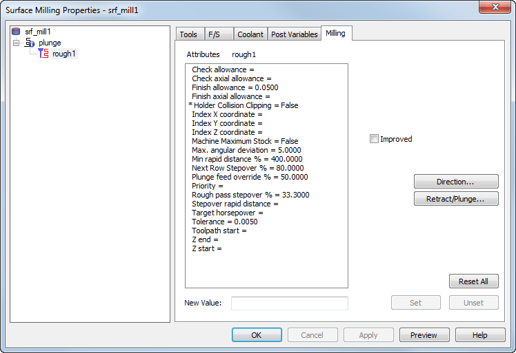

Milling tab (Plunge rough)

Check allowance — Enter the minimum distance that you want to leave around check surface(s). If left blank for a roughing pass, the Finish allowance value is used. If left blank for a finishing pass, the Leave allowance value is used. You can enter a positive or negative value. Set Check surfaces on the Dimensions tab.
Check axial allowance — Enter the amount of axial (Z) material to leave on a check surface. If you enter a value for Check axial allowance, the value for Check allowance is applied to radial (XY) check surfaces only. If you leave Check axial allowance blank, the value for Check allowance is applied to axial and radial check surfaces. You can enter a positive or negative value.
Direction — Click this button to open the Cut Direction dialog.
Finish allowance — Enter the amount of material to leave on a feature after the Rough pass. You can enter a positive or negative value.
Finish axial allowance — Enter the amount of axial (Z) material to leave on a feature after the Rough pass. If you enter a value for Finish axial allowance, the value for Finish allowance is applied to radial (XY) material. If you leave Finish axial allowance blank, the value for Finish allowance is applied to axial and radial material. You can enter a positive or negative value.
Holder Collision Clipping — Clips the toolpath where the holder or shank collides with a part surface, check surface or unmachined stock. Select Holder collision clipping on the feature's Strategy tab to enable it. When enabled, these options are displayed:
  • Holder clearance — Enter the clearance distance for the tool holder. The toolpath is clipped where the tool holder moves within this distance of a part surface or check surface.
  • Shank clearance — Enter the clearance distance for the tool shank. The toolpath is clipped where the shank moves within this distance of a part surface or check surface.
Improved — Enable this option to calculate the true highest Z value where the tool touches the surface. If disabled, the surface is tessellated into a series of approximating triangles and the highest Z value where the tool touches the triangular plane is used. Improved is more accurate, but may be slower to calculate.
Index X coordinate — Optionally enter the absolute X coordinate to use for the index retract move.
Index Y coordinate — Optionally enter the absolute Y coordinate to use for the index retract move.
Index Z coordinate — Optionally enter the absolute Z coordinate to use for the index retract move.
If you do not enter a coordinate, the Z index clearance value is used for the index retract move. Z index clearance is a clearance distance above the stock bounding cylinder. This can result in a Z value for indexing that is outside the valid range for the machine. It can also result in less-efficient retract moves if the part is an irregular shape.
Orientation angle — Enter the initial C-axis position of the part in the machine at the start of the operation.
Min. rapid distance % — Enter the minimum distance, as a percentage of the tool diameter, that the tool can use a rapid move for. Moves smaller than this distance use a feed move.
Minimum rapid distance applies to 2.5D milling. Specify the value as a percentage of tool diameter.
This example shows a feature cut with a value of 400%:
Note: As the tool moves inward, there are few rapid moves. Instead, the tool is fed between passes.
This is the same example with Min rapid distance set to 10% and the tool retracts and rapids between passes.
New Value — To change the value of an attribute in the list, first select it, then enter the new value. Click the Set button to save the new value.
Next row stepover % — Enter the distance between rows of a plunge roughing operation, as a percentage of the tool diameter.
Plunge feed override % — Enter the percentage of the Feed setting to use during a plunge into the material. For example, if the Feed attribute is 2000 MMPM and you set the Plunge feed override % to 50, the resulting feed rate for the initial plunge is 1000 MMPM.
Priority
Reset All — Click this button to reset all of the attributes on the tab to their default values.
Retract/Plunge — Click this button to open the Retract and Plunge dialog.
Rough pass stepover %— Enter the distance between plunge holes in the same row, as a percentage of the tool diameter.
Set — You must click the Set button to save a New Value for the selected attribute.
Note: If you change the value of a numeric attribute, the attribute name is prefixed with a * in the attribute list after you click Set.
Stepover rapid distance — This is used to determine whether to feed or rapid between toolpaths.
Target horsepower — This is the ideal [horse] power for the specified width/depth of cut and feed rate on the specified stock material type.
Tolerance — This attribute controls how accurately the toolpath follows the surface. If your part appears faceted, set the tolerance to a lower value.
Toolpath end —For X Parallel finishing, enter the Y value for the last toolpath. For Y Parallel finishing, enter the X value for the last toolpath.
Toolpath start —For X Parallel finishing, enter the Y value for the first toolpath. For Y Parallel finishing, enter the X value for the first toolpath.
These attributes are available only for parallel finish operation.
Unset — Click this button to return the value of the selected attribute to its default value.
Note: If you have changed the value of a numeric attribute, its name is prefixed by * in the list.
Z end — Enter the distance along the Z axis below which the operation does not mill.
Tip: Use Z end on an earlier operation then follow it with an operation using the Z start attribute so you control the toolpaths efficiently.
Z start — Enter the distance along the Z axis where the milling operation starts. You can use this to save time if the stock material has already been machined away in an earlier operation.
