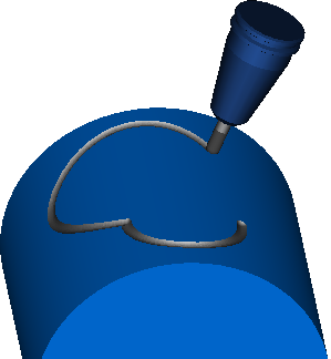

You can perform 5-axis engraving using a 2D spiral toolpath. This enables you to use a tool axis angle normal to the surface to ensure the engraving has a uniform cross-section and depth of cut.

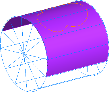

  1. Create a surface below the stock boundary to determine the depth of the engraving, for example:
  2. Create the curve to define the shape of the engraving feature, for example:
  3. Tip: You can use the Construct > Curve > From Surface > Project onto Surface menu option to project a curve onto a surface.

  11. On the 5-Axis tab, select Use Lead and Lean, and in the from list, select Contact normal.
    This keeps the tool axis normal to the surface.
