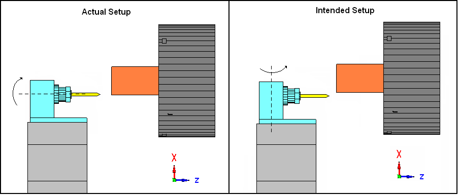

The following warnings may appear in PartMaker when you are attaching tools to holders for Full Machine Simulation:

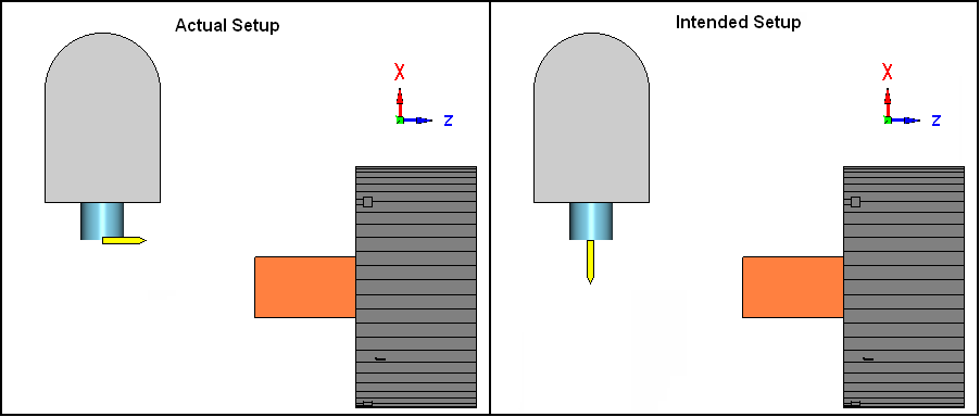

Error 1: You are attempting to mount an X-oriented tool in a Z-oriented position on a turret that cannot rotate about the B-axis.
Error 2: You are attempting to mount a Z-oriented tool in an X-oriented position on a turret that cannot rotate about the B-axis.

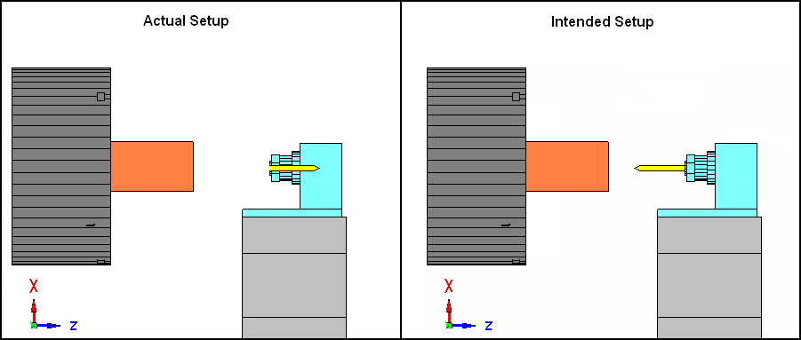

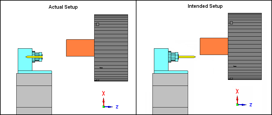

Error 3: You are attempting to mount a Z-oriented tool that is cutting on the main spindle, with its tip facing the sub-spindle.

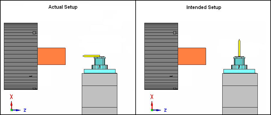

Error 4: You are attempting to mount a Z-oriented tool that is cutting on the sub-spindle, with its tip facing the main spindle.

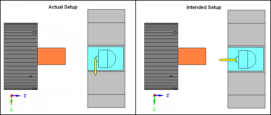

Error 5: You are attempting to attach a Z-oriented tool along the Y-axis.

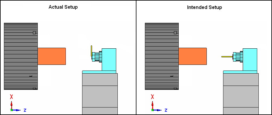

Error 6: You are attempting to attach the tool to Tool Head that is not along the rotation axis of the tool.
Error 7: You are attempting to attach a Compound Rotary Holder with a Rotation Axis along the Z-axis.
