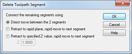

Delete Toolpath Segment dialog
To display the Delete Toolpath Segment dialog, click Delete segment on the Toolpaths tab of the Milling Feature Properties dialog.
When you delete a toolpath segment, you must select how to connect the remaining segments from these options:
  • Direct move between the 2 segments
  • Retract to rapid plane, rapid move to next segment
  • Retract to specified Z value, rapid move to next segment, and enter a Z value
