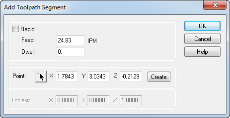

Add Toolpath Segment dialog
To display the Add Toolpath Segment dialog, click Add segment on the Toolpaths tab of the Milling Feature Properties dialog.
This dialog enables you to insert a new point before the currently selected point. For each point you want to create, enter the new Point coordinates, specify a Feed rate or select the Rapid option, optionally enter a Dwell in seconds, and click the Create button. When you have finished creating points, click OK.
Note: If you are creating only one point, you must click the Create button and the OK button.
