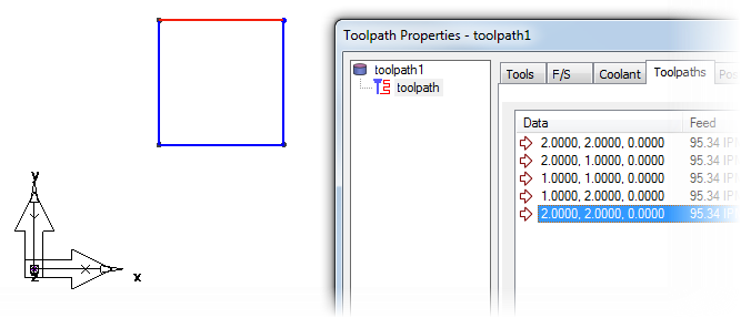

You can use the Toolpaths tab of the Milling Feature Properties dialog to edit a Toolpath feature.
Note: The Toolpaths tab is available for Toolpath features only.
When you select this tab, the Toolpath feature is shown in blue on the part, for example:

The toolpath is displayed as a series of points. If you select a row in the table, the move is shown in red in the graphics area.
To locate a particular point, or series of points in the table, drag-select the points in the graphics window and the appropriate rows of the table are highlighted.
Note: If you want to pick a single point, you must still drag-select a single point. Just selecting it does not work.
