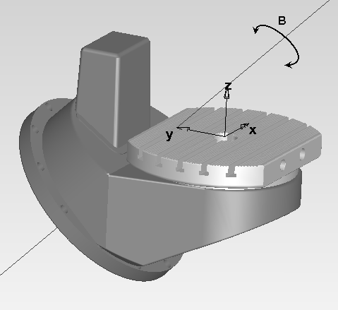

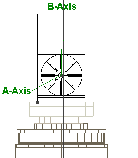

  • B and A stacked rotary tables - these milling machines rotate about the Y-axis, then around the X-axis. They are also called B over A machines.
  • A and B stacked rotary tables - these machines rotate about X-axis then around the Y-axis. These machines are also known as A over B machines.
  • 45 degree angled B and C stacked rotary tables - rotate the B table about a 45 degree angled axis and then rotate about the C table.
  • 45 degree angled A and C stacked rotary tables - rotate the A table about a 45 degree angled axis and then rotate about the C table.
