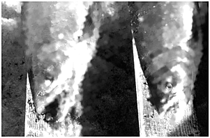

    Original imageAfter using the Impressionist medium
