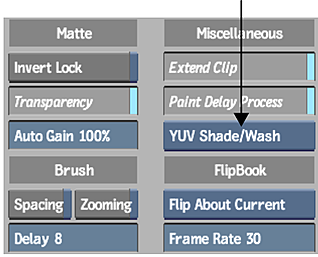

Selecting a Colour Model
You can apply the colour using either the YUV or HLS.
To select a colour model:
  1. Click Setup.
  2. Select either YUV Shade/Wash or HLS Shade/Wash.
