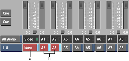

Make sure that the correct video track and audio channel buttons are enabled so that the corresponding video track and audio channels are output to tape.
(a) Video track enabled for output (b) Audio channels 1 and 2 enabled for output
Enable or disable All Audio in the Clip Output menu (to the left of the audio controls).
When All Audio is enabled, all audio channels are sent to the audio converter, not just the ones you enabled in the previous step.
This means you can monitor all audio, even though you are only recording one or two tracks to the VTR. You can also route the other audio channels to a mixer or any other device capable of capturing an audio signal.
