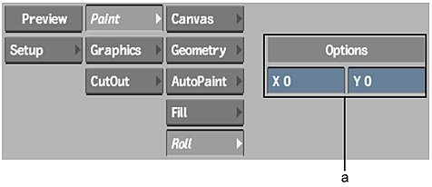

Use the Roll menu to reposition the current frame on the canvas to paint its edges.
To roll the image:
  1. Click Paint.
  2. Click Roll.
    The Roll menu appears.
    (a) Coordinate fields
  3. Zoom in on the image if necessary.
  4. Drag the image using the pan cursor.
    You can also enter the roll values in the Coordinate fields.
  5. To recentre the frame, click Reset.
