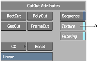

Texture Cut/Paste and Texture Button
Enable Texture Cut/Paste in the Setup menu or Texture in the CutOut menu to speed up cut and paste operations. These preferences are designed for platforms that support fast texture mapping.
(a) Texture button in CutOut menu
The Filtering button can be used when Texture is enabled. Use Filtering to avoid image degradation as a result of recursive cutting and pasting. When Filtering is enabled, the image should not degrade.
