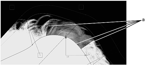

(a) Pickers—Colour analysis is done in the area inside the pickers.  

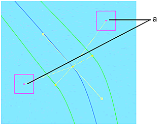

The area that each picker affects extends halfway towards the two adjacent mask vertices, and up to the two softness borders, as shown in the following example.
(a) Borders of area of pickers' influence.  
Using pickers, you can key objects that otherwise would be extremely difficult to key. Imagine a golden horse with a very fine mane on an unfocused background of various colours. As long as you have some chroma/luma differences in the background (green vegetation, blue sky, black earth or rocks), you can 'force' the outside pickers to sample these colour values. The inside pickers can sample the golden average values, and the Tracer can generate a soft-edged matte based on the difference between the two sets of values.
