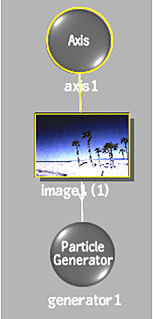

  3. With the surface node selected in the schematic, do one of the following:
    • Drag the particle generator node from the node bin and place it in the schematic.
    • Double-click the particle generator node. You do not need to be in Schematic view to add a node in this manner.
    A particle generator object is added and automatically connected to the selected surface.
