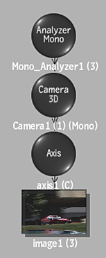

In the schematic view, you can see that an Analyzer node is added to the scene. The number in brackets next to the name of the Analyzer node indicates the media used for the analyzer (a zero (0) indicates Back media). The Analyzer node is parented to a 3D Camera node, which is synced to the analysis of the Analyzer node, as well as an Image (or Stereo Object) node with an axis.
