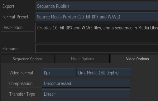

Simple Link Media (Bit Depth) example:
  1. Import a sequence of 50 .dpx files, with a bit depth of 10-bit.
  2. Of that sequence, you colour correct only the first 10 frames.
  3. Export that sequence as a Sequence Publish, using the format preset Source Media Publish (10-bit DPX and WAVE). Notice how in the menu Video Options, the box Link Original Media is set to Link Media (Bit Depth).
  4. The result of the export is 50 .dpx files:
    • 10 new .dpx files created by Flame
    • 40 .dpx files referencing the original files
    The last 40 files are referenced, and because they were neither created nor moved, the export process was that much faster.

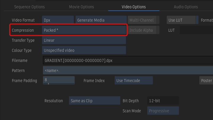

If the source media is not available, Flame can link to the media cache instead, but on the following conditions:
  • You export the sequence to the volume that holds the media cache.
  • You select Link Media (Bit Depth) or Link Media (Compression).
  • You select the compression indicated by the asterisk ( * ) in the Compression drop-down box. The asterisk indicates the compression format used by the media cache.
