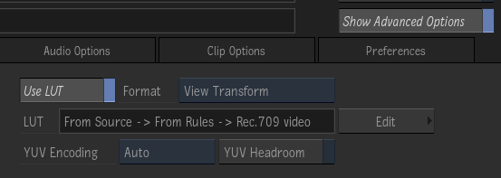

LUT Activation button
Enable to apply the LUT or colour transform displayed in the Applied LUT field to the clip.
Format box
When Importing: Select Colour Transform unless you're applying a legacy format 1D or 3D LUT. When Exporting: View Transform applies viewport colour management to the export; Input Transform applies import colour management (or its inverse) to the export; Colour Transform is for CTF and most other formats except a legacy 1D or 3D LUT; Tag Only overrides the colour space written to an OpenClip XML file.
Applied LUT field
Displays the type of conversion LUT applied to the clip, either imported using Import, or edited using Edit.
Colour Management Access button
Click to configure colour management settings.
Video Range box
Select between exporting a Full range or Legal range clip. Unless you have specific requirements, consider keeping the default value.
YUV Encoding box
Select the clip's YCbCr colour encoding matrix. The application uses this to translate native RGB values into YUV ones. The Auto setting selects the colour encoder based on the resolution of the clip: Rec. 601 for clips with a resolution lower than 720 lines, Rec. 709 for everything else.
Flame works in an RGB colour space: it needs to translate RGB information back into YUV. This setting ensures that the right encoder is used for this. Specifying the wrong option will result in colour problems upon decoding. Per Recommendation BT. 2020, UHD media should use the Rec. 2020 colour space. But this is rarely the case at the moment: UHD clips still use Rec. 709. The Rec. 2020 option is there is case you need the new standard.
Format box
Select View Transform to apply viewport colour management to the export. Select Input Transform to apply import colour management (or its inverse) to the export. Select Colour Transform for CTF and most other formats except a legacy 1D or 3D LUT. Select Tag Only if you want to override the colour space written to an OpenClip XML file.
Applied LUT field
Displays the type of colour management applied to the clip, either imported using Import, or edited using Edit.
Import button
Browse and select a colour transform.
Click to open the Colour Management editor.

Field 1A clip by drawing Field 1 followed by Field 2.
Field 2A clip by drawing Field 2 followed by Field 1.
Note that in the case of IMX exports, the Scan Mode box is ignored: NTSC clips are always exported as F2 dominant, while PAL clips are always exported as F1 dominant.
Audio Options Tab
Audio Format box
Select the audio format of the exported audio tracks. If Export Type is Movie, the audio is embedded within the video file. Any other Export Type outputs a separate audio file.
Audio Bit Depth box
Select the bit depth of the exported audio file.
Audio Compression field
Select the compression for the exported audio file. The available options depends on the Audio Format.
Audio Sample Rate box
Select the sample rate of the exported audio.
Audio Mixdown box
Select a mixdown to apply to the audio tracks, if any are included with the source clip.
Select:To mix down:
No MixdownNothing
Mixdown As IsWith the current output strip assignments.
Mixdown To 4 tracksTo four tracks. The output strips are assigned sequentially in fours to the mixed-down channels (where M1 goes to 1, M2 to 2, M3 to 3, M4 to 4, M5 to 1, and so on).
Mixdown To StereoTo one stereo track. The output strips are assigned sequentially in twos to the mixed-down channels (where M1 goes to 1, M2 to 2, M3 to 1, M4 to 2, and so on).
Mixdown To MonoTo one mono track.
Filename field
Displays the result of the pattern displayed in the Filename Pattern field.
Displays how to name the exported media files. Build a dynamic naming scheme using Add Token and characters normally allowed in a file name. Create folder structure using / . The file extension is automatically appended. Add '#' to numerical tokens to define padding.
Add Token box
Inserts a token in the Pattern field to build a dynamic filename.
Clip Options Tab
Copy Exported Clip in Media Library button
Enable to automatically create a copy of the exported clip in the Media panel, linked to the exported media files. Available when performing a Sequence Publish with a File Sequence, with no resize or bit depth change.This is similar to importing back the exported media with Cache Source Media disabled.
Create Clip Data button
Enable to create a .clip file for the exported sequence. A .clip contains extended metadata about the exported sequence, and enables versioning. The name of the .clip appears in the Filename field.
Clip Versions button
Enable to version the exported sequence. This allows you to track revisions to the sequence.
Clip Filename field
Name of the .clip created for the sequence. It displays the result from the Pattern field below.
Clip Filename Pattern field
The pattern used to name the .clip created for the sequence. Use the Add Token box to use pre-defined tokens to build the name.
Create Shot Setup button
Enable to export a Batch setup and a .clip file for every segment with a shot name in the exported sequence. Only segments with non-empty Shot Name generate an associated .batch and .clip. For Shot Publish exports.
Shot Setup Filename field
Example of the names given to the shot setup created each segment with a shot name. It displays the result from the Pattern field below.
Shot Setup Pattern field
The pattern used to name each shot setup file. Use the Add Token box to use pre-defined tokens to build the name.
Shot .Clip Filename field
Example of the names given to the shot .clip created each segment with a shot name. It displays the result from the Pattern field below.
Shot .Clip Pattern field
The pattern used to name each shot .clip file. Use the Add Token box to use pre-defined tokens to build the name.
Output Path field
Example of an output path and name used by the Write File node of a generated Batch setup. Displays the result of the Pattern field below.
Output Path Pattern field
The pattern used to create the Output Path to ensure that the Write File node of each generated Batch setup uses a different path and name. Use the Add Token box to use pre-defined tokens to build the path.
Create Batch button
Enable to create a Batch Group for each shot, back in the application at the location set in the Batch Group Path field.
Location in the application's Workspace where the Batch Group is created. Enabled by Create Batch.
Create Clip Nodes button
The type of media nodes created in the Batch Setup.
