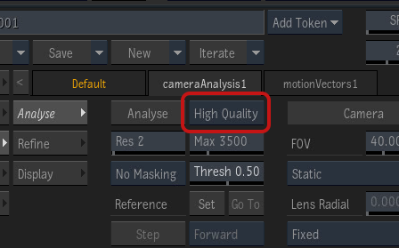

Motion Vectors Quality Setting
You can now set the quality and speed of the Motion Vectors analysis in the Analyse submenu.
QualityDescription
FastThe resolution of the Motion Vectors map is lowered, speeding up the analysis.
This is the default option.
IntermediateThe resolution of the Motion Vectors map is higher than with the Fast option. Intermediate is a good compromise between quality and performance.
High QualityThe resolution of the Motion Vectors map matches that of the analyzed media. This option is the highest possible quality.
This option matches the behaviour found in Flame Family 2022.
CustomDisplayed only if you edit the resolution of the Motion Vectors map—Controls Motion Estimation Resolution.
In effect, Analysis Quality controls the resolution of the Motion Vectors map: Fast resizes the map to 720 pixels in height, Intermediate to 1080. High Quality uses the full resolution of the map. While Fast and Intermediate speed up the analysis, they can also result in trackers losing the accuracy available to the High Quality setting.
Troubleshooting: Analysis Quality is stuck at Fast or High Quality
Analysis Quality is locked atReason
High QualityThe Motion Vectors map has height resolution of 720 pixels or lower. Since Fast and Intermediate cannot improve performance by lowering the resolution, they aren't available.
High Quality or
Fast
The Motion Vectors map has height resolution between 720 and 1080 pixels. Since Intermediate cannot improve performance by lowering the resolution to 1080, it isn't available.
