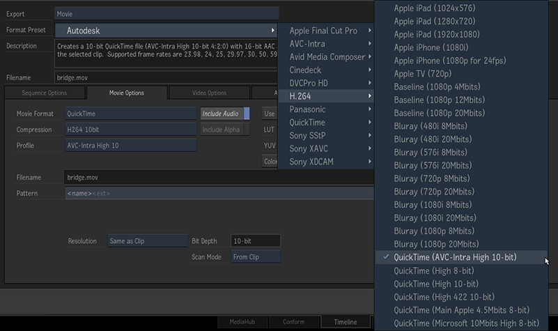

QuickTime Encoding (What's New in 2022.1)
You can now export clips as QuickTime H.264 10-bit movie files.
New H.264 QuickTime encoding profiles are now available when exporting QuickTime movie files. These profiles are not limited in resolution or frame rates.
These new presets are found under the H.264 Export menu options.
Available H.264 QuickTime encoding presets
