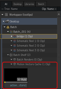

When you cache a Motion Vectors map in Batch or Batch FX, you now also create a new clip: a motion vectors clip. This clip stores the Motion Vectors cache, and behaves like any other clip: you can reuse it in another setup, wire it to another project, or even archive it.
  1. To create the Motion Vector cache:
  2. Open a Motion Vectors map.
  3. Click Analysis Integration Cache Range.
When you cache a Motion Vector map, the following happens:
  1. An orange dot appears next to the map.
  2. A clip is created in:
    • The map is cached in a Batch Group: The clip appears in the Batch Shelf Motion Vectors Cache.
    • The map is cached in a BFX: The clip appears in a the library Motion Vectors Cache, in a folder named after the clip and the timeline segment.
