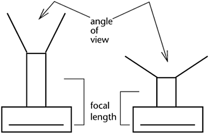

About the Angle of View
The angle of view, or more accurately, the angular field of view, is the amount of a scene (measurable in terms of an angle in degrees, originating at the camera position) that can be viewed by the camera. The angle of view is not affected by changes in the distance between camera and subject. It can be modified directly, in the FOV field, or indirectly, via the Focal Length field.
The angle of view and the focal length are inversely proportional. As you extend the camera's focal length, the field of view gets narrower. As you shorten the focal length, the field of view gets larger.

Focal Length
The focal length of a lens is the distance from the centre of the lens to the film plane. The shorter the focal length, the closer the focal plane is to the back of the lens. Focal length is usually expressed in millimeters.
The object's size in the frame is directly proportional to the focal length. If you double the focal length (keeping the distance from the camera to the object constant), the subject appears twice as large in the frame. The size of the object in the frame is inversely proportional to the object's distance from the camera. If you double the distance, you reduce the size of the object by half in the frame.
