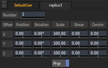

Replica Menu Settings
Number field
Displays the number of instances of the attached object to create. Each instance creates its own entry in the Action Priority Editor, so you can change the drawing order of instances.
X Position field
Displays the position offset along the X axis.
Y Position field
Displays the position offset along the Y axis.
Z Position field
Displays the position offset along the Z axis.
X Rotation field
Displays the rotation offset along the X axis.
Y Rotation field
Displays the rotation offset along the Y axis.
Z Rotation field
Displays the rotation offset along the Z axis.
X Scale field
Displays the scale along the X axis.
Y Scale field
Displays the scale along the Y axis.
Z Scale field
Displays the scale along the Z axis.
Proportional
Enable to change the fields proportionally.
X Shear field
Displays the shear along the X axis.
Y Shear field
Displays the shear along the Y axis.
Z Shear field
Displays the shear along the Z axis.
X Centre field
Displays the centre offset along the X axis.
Y Centre field
Displays the centre offset along the Y axis.
Z Centre field
Displays the centre offset along the Z axis.
