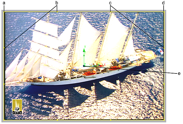

By default, the extended bicubic surface has four vertices and eight tangents. You can translate, scale, or rotate these points and tangents individually or as a group. Subdividing the bicubic surface increases the number of vertices in the image and allows for more precision.
(a) vertex 1 (b) tangents of vertex 1 (c) tangents of vertex 2 (d) vertex 2 (e) Reference point
Image courtesy of Topix
Extended bicubics have three types of points: vertices, tangents, and the reference point. Vertices and tangents are collectively called surface points.
Vertices lie on the surface and its tangents determine the curvature of the deformation at each vertex. The reference point indicates the axis of origin for applying rotation and scaling to surface points.
Use the surface points to control the deformation of the surface. Each vertex has tangent handles. By moving the tangents and their handles, you can warp specific areas of the surface. You can translate, scale, or rotate these points and tangents individually or as a group.
