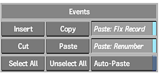

Events Group
Use the commands in the Events group to cut or copy single or multiple events and paste them to a new location in any open EDL. You can also use special paste functions and selection tools for events.
Insert Event button
Inserts a new event into the EDL.
Cut Event button
Cuts the selected event. May be used with Paste Event button.
Copy Event button
Copies the selected event. May be used with Paste Event button.
Paste Event button
Pastes the previously cut or copied event to the selected location.
Paste: Fix Record button
Enable to change Record In of the first pasted event to start at Record Out of the previous event. All pasted events are then rippled by the same amount.
Paste: Renumber button
Enable to automatically renumber all events according to the Next Event value in the Renumber Events menu. If this option is disabled, the pasted events retain their original event numbers.
Select All button
Click to select all events for capture.
Unselect All button
Click to unselect all events.
Auto-Paste button
Enable to quickly cut events from multiple EDLs and automatically paste them to a single EDL. For a selected EDL, when clicking the Paste button, any events that are cut or copied are automatically pasted to the first EDL.

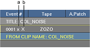

You can mark events for capture or select only the uncaptured ones for recapture.
Mark button
Click to mark the selected events for recapture with an “X”. This allows you to keep track of events that you want to recapture. Events that have already been captured are marked with a lower case x. Therefore, when you mark a captured event for recapture, a lower and upper case x appear (x X) to the right of the event number.
(a) Capture mark (b) Recapture mark

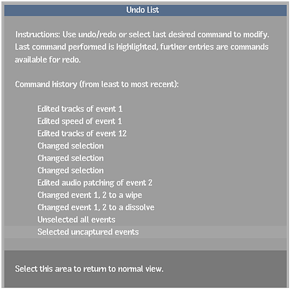

Undo List View all modifications (up to the number of undo levels specified in the Preferences menu) that you made in the current session, and undo a single or series of commands. Click the item in the undo list that you want to undo. All operations are undone up to and including that modification. All operations prior to the highlighted modification are redone.
Tape List Display the Tape List view, showing the last selected EDL.
Tape List (All EDLs) Display the Tape List view, showing all selected EDLs.
Undo List View
Use the Undo List to view all modifications (up to the number of undo levels specified in the Preferences menu)that you made in the current session and undo a single or series of commands.
Click the item in the Undo List that you want to undo. All operations are undone up to and including that modification. All operations prior to the highlighted modification are redone.

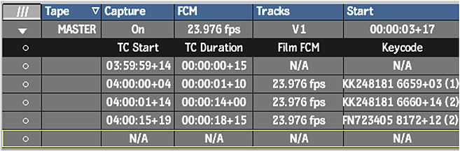

Tape List View
You can use the tape list to modify information pertaining to events for a given tape.
As well, each tape's entry can be expanded in Tape List view to show keycode and 2:3 pulldown information associated with the source timecode.
Click the column header to sort the tape list in descending order using that column. Click the column heading again to sort the tape list in ascending order.
The work area of the Tape List view is divided into nine columns, and two sections for each tape.
The upper fields of each tape entry contain the following columns.
Tape
The name of the tape that contains the source footage. To change the tape name, click and enter a new name.
Capture
The capture flag for the tape. When set to On, the tape is captured during an auto-capture session. To set the capture flag for a given tape to On or Off, click the item under the Capture column and drag left or right to set it On or Off.
FCM
The frame code mode for the tape. If the frame code mode is 29.97, you can drag over the item in this column to switch between DF/NDF modes.
Tracks
The number and type of tracks that will be captured for the tape.
Start
The starting timecode for the first event to be captured on the given tape.
Capture Time
The duration of the material to capture for the given tape.
Telecine
Indicates the telecine log associated with the tape.
Final Telecine
Indicates the final telecine log associated with the tape.
Events
The number of events to capture for the given tape. You cannot modify this value in Tape List view.
The lower fields of each tape entry contain the following columns.
TC Start
Start timecode for each keycode sequence.
TC Duration
Duration of time for the keycode sequence.
Film FCM
Film frame code mode indicating the speed of the telecine when it scanned the film frames. Change the film FCM by clicking the Keycode field to access the calculator.
Keycode
Keycode for the first frame of the sequence.
Removal
Whether to apply 2:3 pulldown to the sequence.
Ref Frame
Timecode of the reference frame.
Ref Type
Type of reference frame.
DF Ref Frame
Timecode of the drop frame reference frame.
