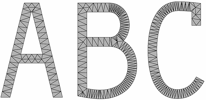

Delaunay
The Delaunay tessellation method (or more precisely, constrained Delaunay tessellation) generates a mesh composed entirely of triangular polygons. This method gives consistent and predictable results, and in particular, it does not give different results if the curves are rotated.
With this method, there are several options for fine-tuning the tessellation further.

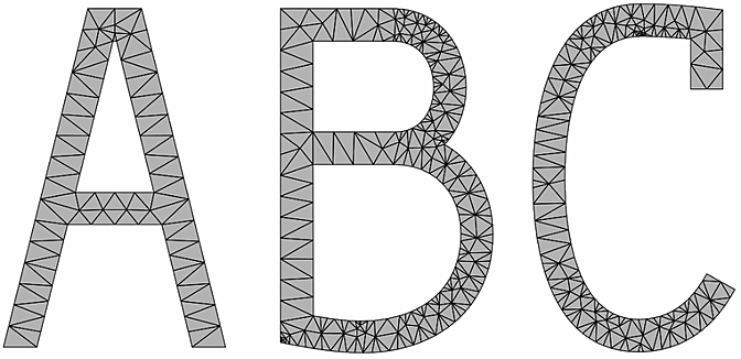

Min Angle field
Displays the smallest value of angle that the polygons can have. If a triangle contains an angle that is smaller than this value, it gets replaced by better-shaped ones. Eliminating small-angled triangles gives a more uniform shading and is more suited for deformations.
Min Angle = 20

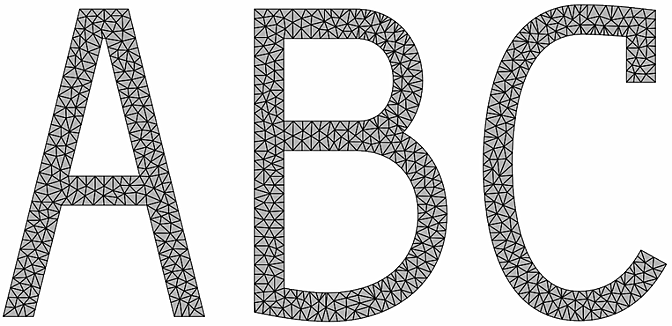

Max Area field
Displays the largest value of area that the polygons can have. If a triangle is larger than this value, it gets replaced by smaller ones. This allows the polygon mesh to be deformed more smoothly.
Max Area = 5

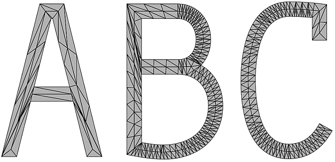

Boundary Split option
Select an option to control tessellation along boundaries.
Select: To:
Free Allow the boundary edges along the outer contour and inner holes to be split further during tessellation.
This is particularly useful for text and other shapes that may contain straight edges that need to be deformed smoothly.
None (Contour Only) Allow boundary edges along inner holes to be split, but not boundary edges along the outer contour.
Note that this may affect the uniformity of the mesh if you enabled Min Angle or Max Area.
None (Contour and Holes) Prevent any boundary to be split.
