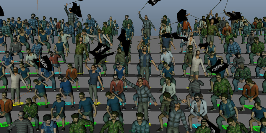

- When playing a static motion (e.g. spectators sit in a stadium)
- When the motion should be controlling the character position without constraints (i.e. the particle is not controlled by GoTo/Navigation Behavior or Maya field and you do not want to ensure any constraint on the character position/orientation)
Getting variety in a stadium using Motion Behaviors. See Stadium Behaviors

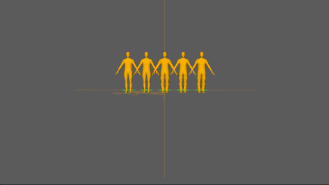

- if you want a row of characters to simply walk forward, but need to randomize motion start time. If you just use a Motion behavior for this, their orientation when starting can be different and they will end up colliding. Use a SyncMotion Behavior or a Locomotion Behavior instead.
Result of applying a Motion behavior with random start percent between 0
and 1, see the right solution below

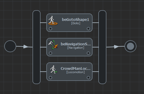

- When you need a complex blending of motions depending on characters speed/orientation (typically a character walking or a bird flying)
- When controlling the character position with another behavior (GoTo/Navigation) or method (Maya fields, particle goals...)
The usual Locomotion + GoTo/Navigation behaviors setup, see Populating City Streets for more details

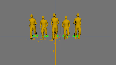

Same situation as above, made with a SyncMotion Behavior. See the
Playing Motions Straight Ahead with Random Start

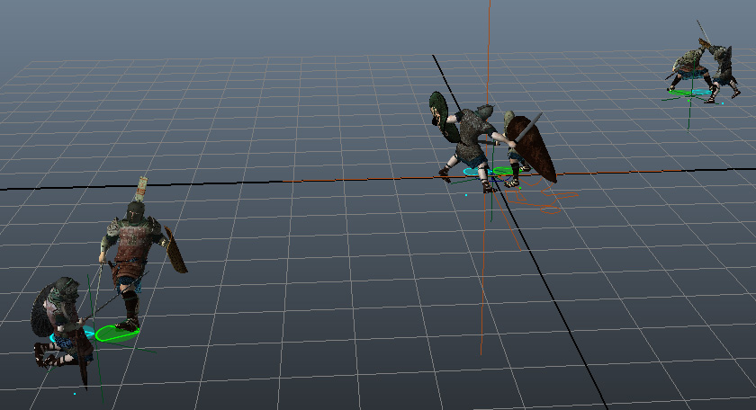

- To play a motion keeping the same offset to scene origin when it was recorded
Synchronized Close Combat action using the SyncMotion Behavior. See
this tutorial
