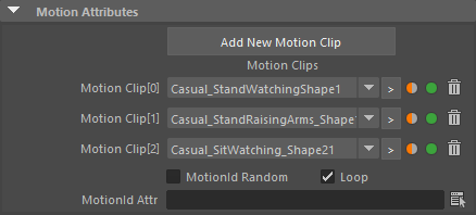

Motion Attributes
Motions Files (.gmo / .fbx / .usd / .bvh files)
Motion Clips to play when this behavior is started. If several Motion Clips are specified, each character will pick one when the behavior starts. The same chosen Motion Clip will be played if the Motion Behavior loops (see below) or restarts.
Use the "Add New Motion Clip" button and the trash icon to add or remove motions.
Use the ">" button to select the related Motion Clip node and access to its attributes.
Use the  icon to mirror the relative animation ( to load the original animation, to load the mirrored animations,  to load both original and mirrored animation). For mirror animation to work properly, the mirror must be correctly configured on the skeleton mapping, as explained on this page.
Use the  icon to enable / disable a Motion Clip without removing it from the behavior.
You can add Motion Clips (and their related motion files) directly by double-clicking on the behavior in the Behavior Editor and by selecting one or several motion files in the dialog.
Motion Id Random If unchecked, Motion Clips will be assigned sequentially to Entities (first character will play the first motion...) else they will be assigned randomly
Loop If checked, the Motion Clip will loop automatically when it reaches the end. If not, the behavior will hold the last frame of the animation until it is stopped
Motion Id Attr Name of the float Golaem Attribute or per-particle field of the relative particle system, containing the Motion Clip index value which will be played for this Character (For more explanation about how to use Golaem or PPAttributes, see here). If the index value is out of bounds it's moduloed and if the attribute does not exist, the regular behavior (sequential picking) is executed.

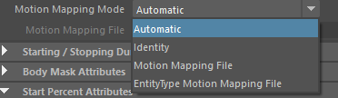

Motion Mapping Mode / Motion Mapping File
This attribute allows a choice of four motion mapping mode:
  • Automatic: In this mode, Golaem Crowd will try to build a Motion Mapping automatically. This will work in most cases but you may have to build a Motion Mapping File if the motion is not replayed as desired (see here)
  • Identity: In this mode, each channel will replay the same channel index (ie. channel 0 in entity's skeleton will replay channel 0 in motion's skeleton, channel 1 will replay channel 1, ...). Use this mode when playing an animation built from the same skeleton as the entity's skeleton
  • Motion Mapping File (default mode): In this mode, a valid Motion Mapping File (.gmm) should be provided. To learn how to create your Motion Mapping File, see here
  • EntityType Motion Mapping File: In this mode, a valid Motion Mapping File (.gmm) should be provided in the corresponding EntityType Node. To learn how to create your Motion Mapping File, see here

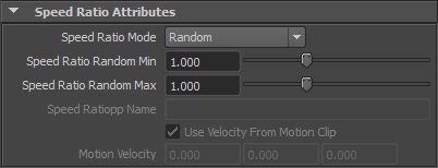

Speed Ratio Attributes
The Speed Ratio is applied when playing the Motion. If set to 1, the Motion is played at its original speed.
Speed Ratio Attributes of a Motion Behavior
Speed Ratio Mode This attribute allows a choice of four Speed Ratio modes :
Speed Ratio modes of a Motion Behavior
  • Random: Randomly set the Speed Ratio value between the specified "Speed Ratio Random Min" and "Speed Ratio Random Max" bounds (this attribute is influenced by the random seed of the Crowd Manager)
  • Per-Particle Attribute: Use the "Speed Ratiopp Name" attribute to get the name of the float per-particle field of the relative particle system, containing the Speed Ratio value. The value of this PPAttribute can be animated.
  • Golaem Attribute: lets you set the speed ratio from a Golaem attribute. The value of this Golaem attribute can be changed dynamically
  • Automatic: Analyze the input motion velocity (root total translation / duration of the motion) and change it at each frame depending on the particle velocity and the size of the character.
Speed Ratio Random Min See Random option of the Speed Ratio Mode above
Available only when the Speed Ratio Mode is set to "Random"
Speed Ratio Random Max See Random option of the Speed Ratio Mode above
Speed Ratio Attr Name
Name of the float per-particle field of the relative particle system, containing the Speed Ratio value which will be used on the Motion (for more explanation about how to use ppAttributes, see ppAttributes Handling)
Speed ratio value is set to 1 if the ppAttribute name is empty or invalid
Available only when the Speed Ratio Mode is set to "Per-Particle Attribute" or "Golaem Attribute"
Use Velocity From Motion Clip If checked, the input motion velocity will be computed from the Motion Clip; otherwise the Motion Velocity will be set from the "Motion Velocity" field below
Available only when the Speed Ratio Mode is set to "Automatic"
Speed Ratio Random Max See Use Velocity From Motion Clip above
Available only when the Speed Ratio Mode is set to "Automatic" and if the "Use Velocity From Motion Clip" option is not checked

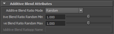

Additive Blend Attributes (Additive Blend Mode only)
If several Motion behaviors (setup in Additive blend mode) are played at the same time on the same part of the body, each of these behaviors will be blend/added in a given amount  according to the specified Additive Blend Ratio, divided by the number of running additive behaviors (for instance, if two Motion behaviors M1 and M2 are run in Additive Blend Mode in the same time respectively with additive blend ratio of 1.0  and 2.0, the resulting animation will be added an amount of 50% of M1 and 100% of M2).
Additive Blend Attributes of a Motion Behavior

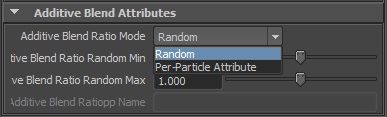

Additive Blend Ratio Mode This attribute allows a choice of two Additive Blend Ratio modes :
Additive Blend Ratio mode of a Motion Behavior
  • Random: Randomly set the Additive Blend Ratio value between the specified "Additive Blend Ratio Random Min" and "Additive Blend Ratio Random Max" bounds (this attribute is influenced by the random seed of the Crowd Manager)
  • Per-Particle Attribute: Use the "Additive Blend Ratiopp Name" attribute to get the name of the float per-particle field of the relative particle system, containing the Additive Blend Ratio value
Additive Blend Ratio Random Min See Random option of the Additive Blend Ratio Mode above
Available only when the Additive Blend Ratio Mode is set to "Random"
Additive Blend Ratio Random Max See Random option of the Additive Blend Ratio Mode above
Additive Blend Ratiopp Name Name of the float per-particle field of the relative particle system, containing the Additive Blend Ratio value which will be used on the Motion (for more explanation about how to use ppAttributes, see ppAttributes Handling)
Additive Blend Ratio value is set to 1.0 if the ppAttribute name is empty or invalid
Available only when the Additive Blend Ratio Mode is set to "Per-Particle Attribute"

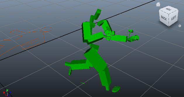

Motion Show the Name of the Motion in use inside the Crowd Visual Feedback
Motion Clip visual feedback for a Motion Behavior
