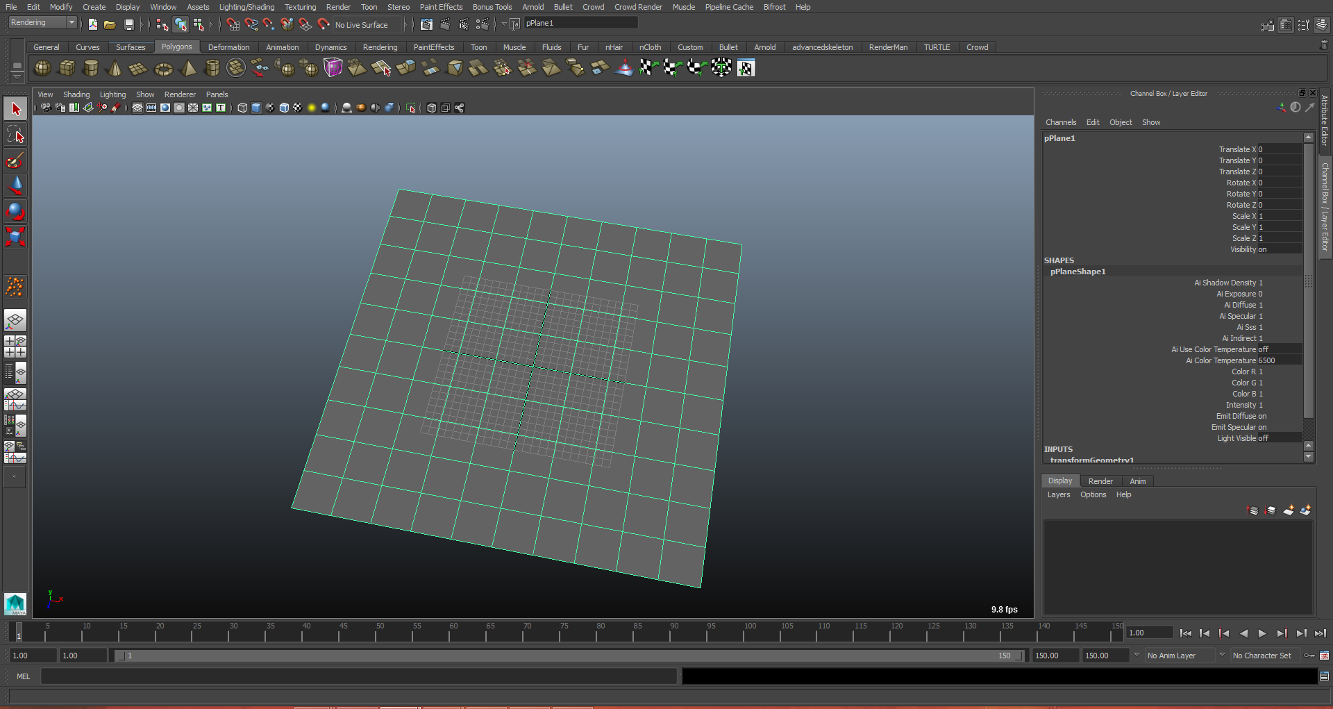

2. When you are done, switch to Maya and create a polygon to place your
crowds on. Do not forget to freeze its transform (Maya/Edit/Freeze

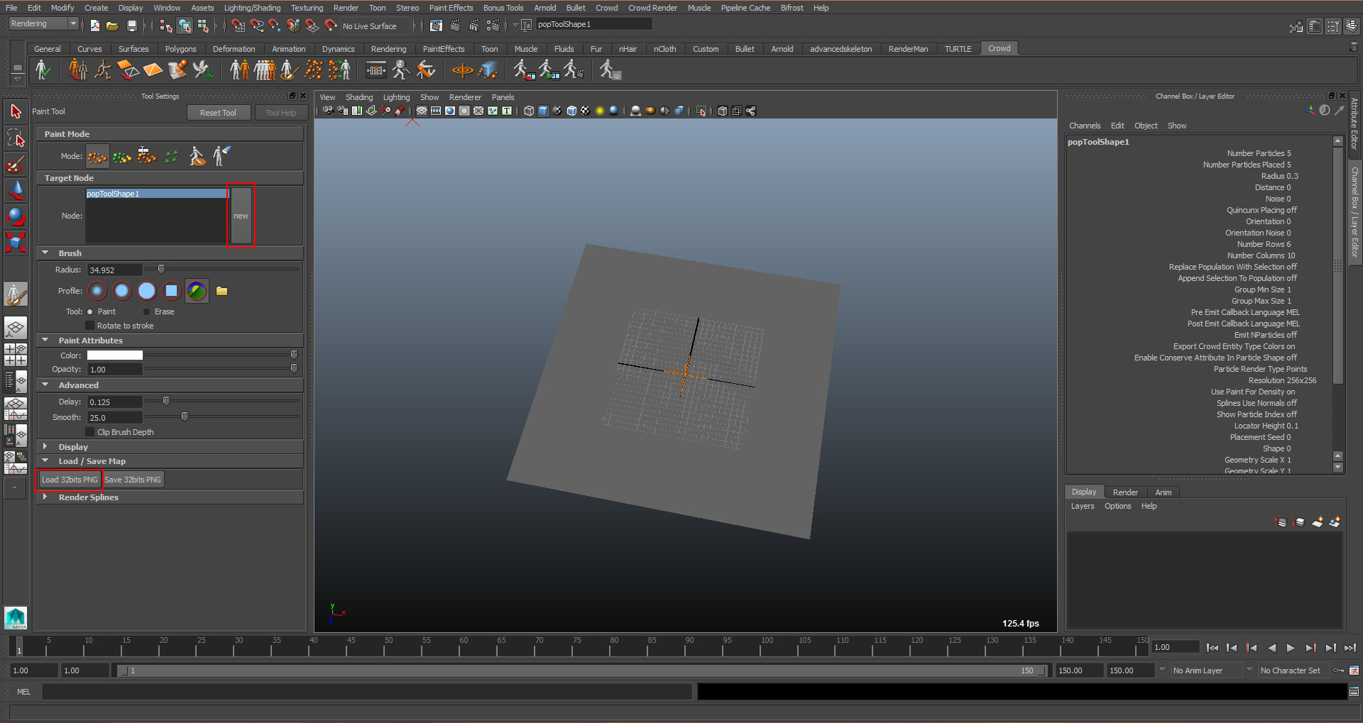

Transformation). Then select it and click on the Golaem Crowd Paint Tool icon

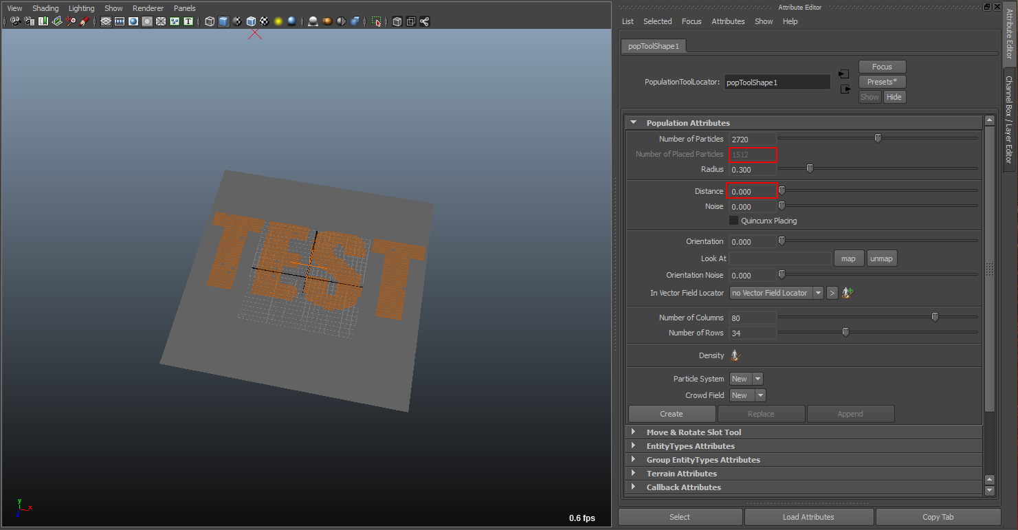

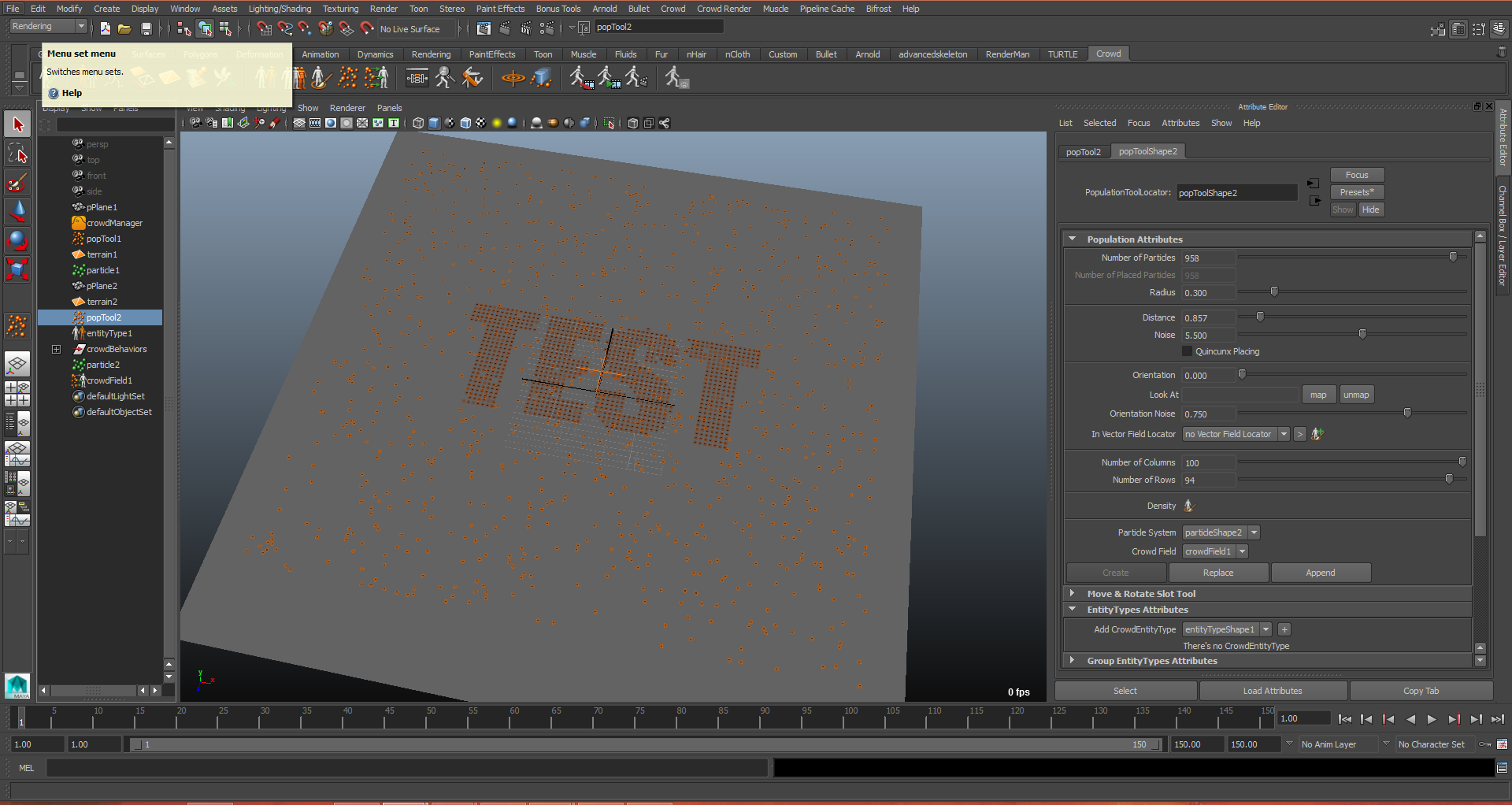

3. In the Tool Settings Panel, select the Population Mode and click New. Then click on the Load 32bits PNG below and browse to your logo image. Golaem Crowd will create a population tool based on the color of your image.

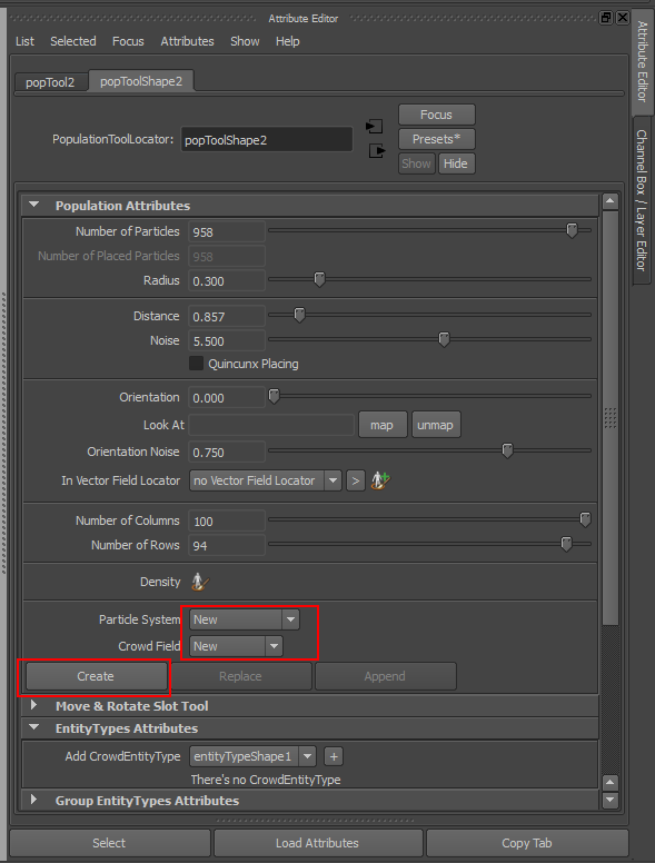

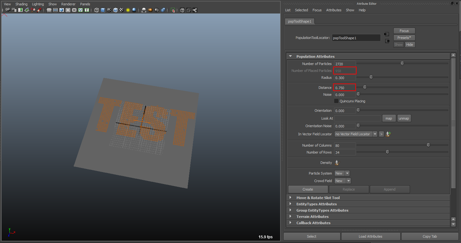

4. There may be too much particles for our simulation and the space between them will be too tight for them to be able to move.
5. You can fix this by increasing the distance parameter in the Population Tool
6. This Population Tool will be used to generate target particles and not Golaem Crowd characters so we do not want it to be linked to a Crowd Field. Set Crowd Field to none and particle system to new, then click on create.

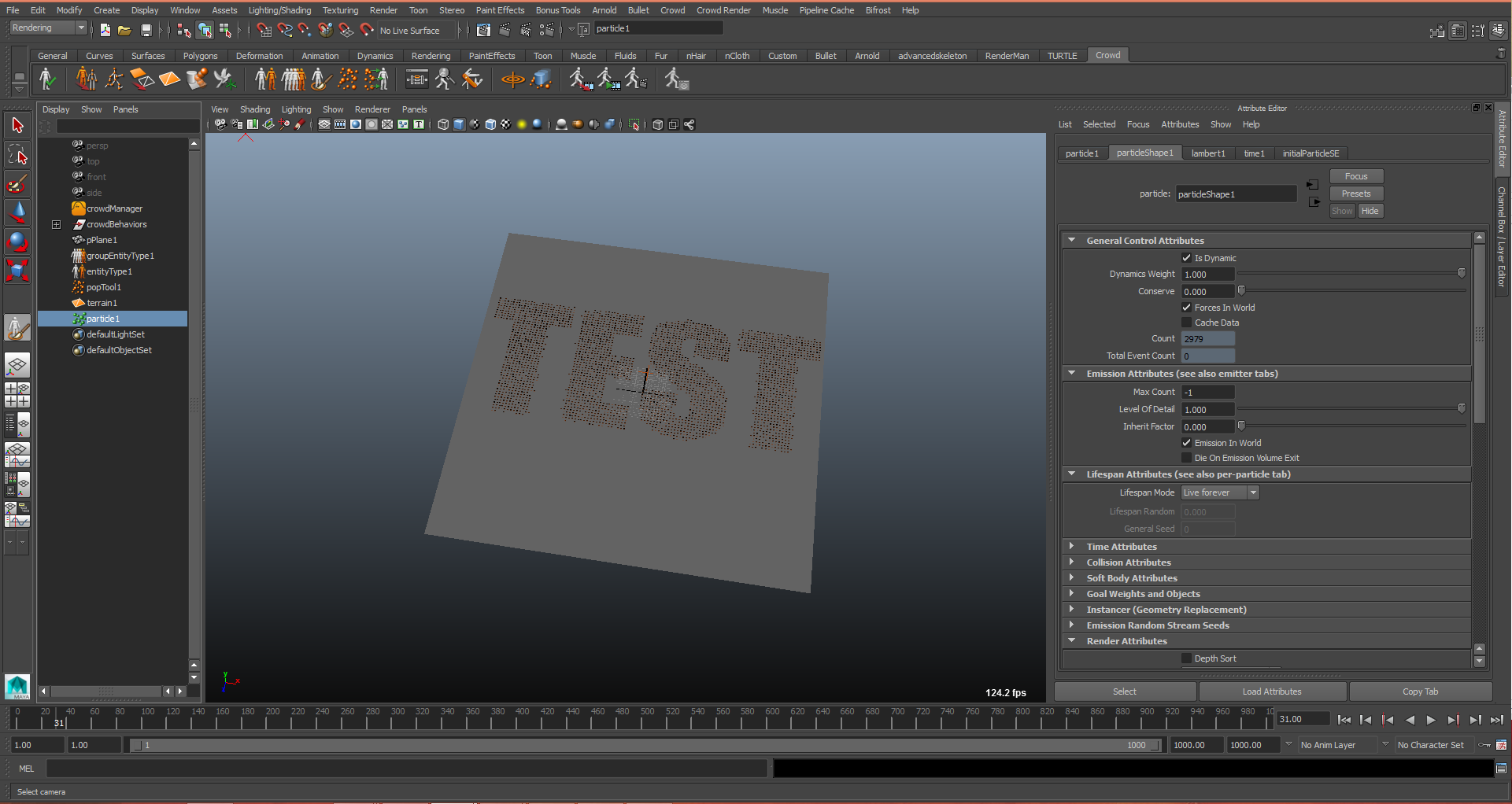

7. The target particles are now created.
CREATING THE CROWD

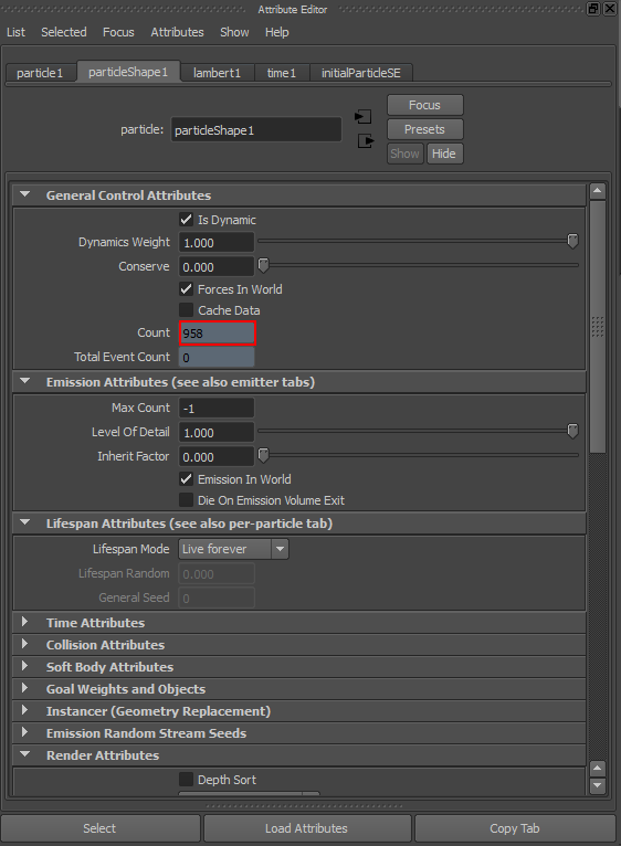

8. Select your particle system and in the attributes ckeck the number of placed particles

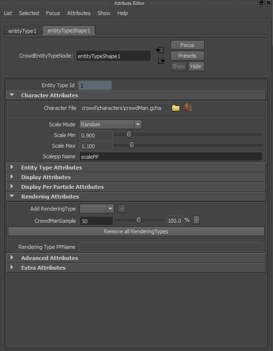

9. We are now going to create our entities. Create one
EntityType
and load the crowdman character
from the samples (don’t forget to
add the renderingType)

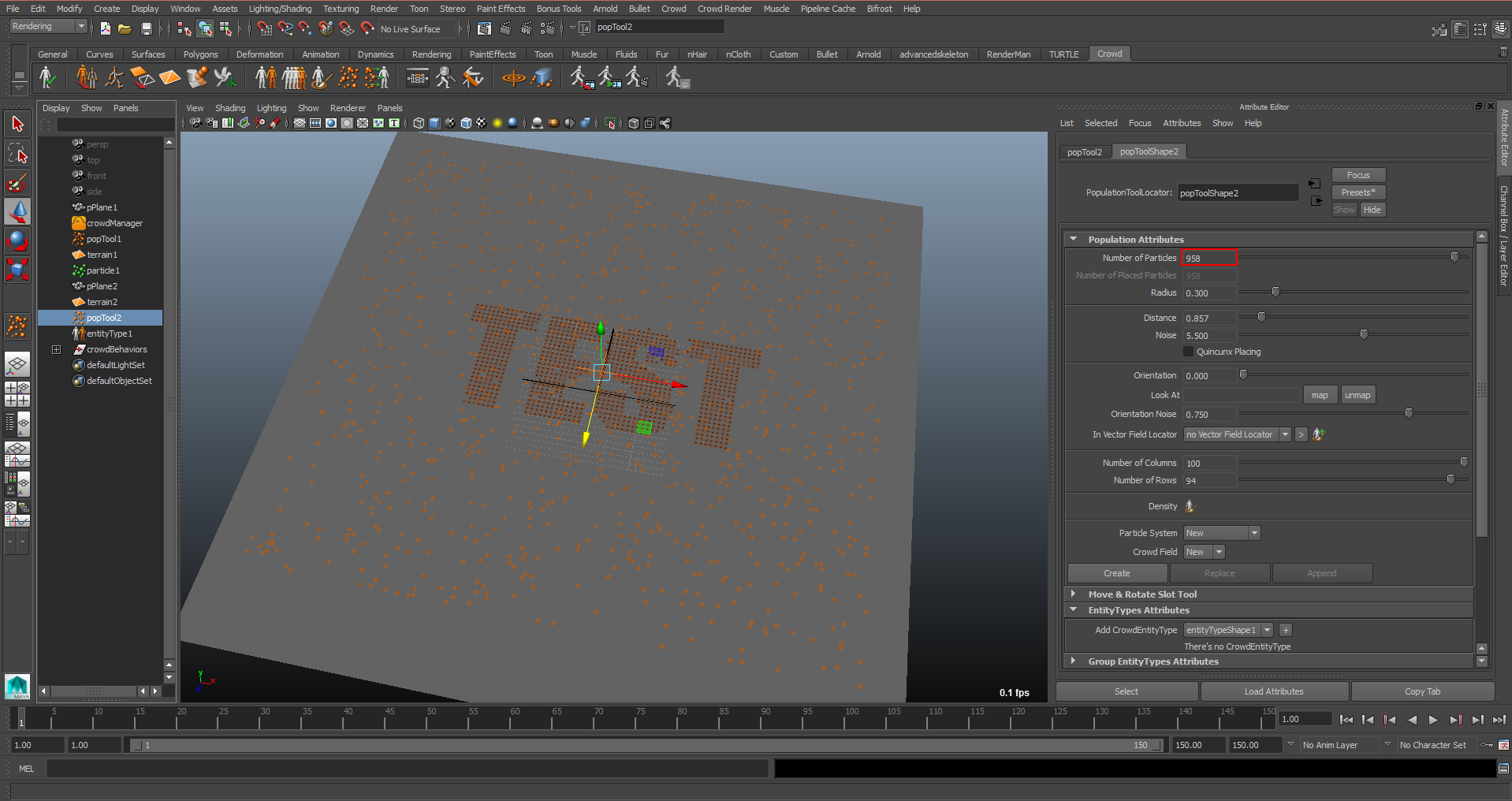

10. Create a new Population Tool
(larger but with the same number
of particles than the first one.

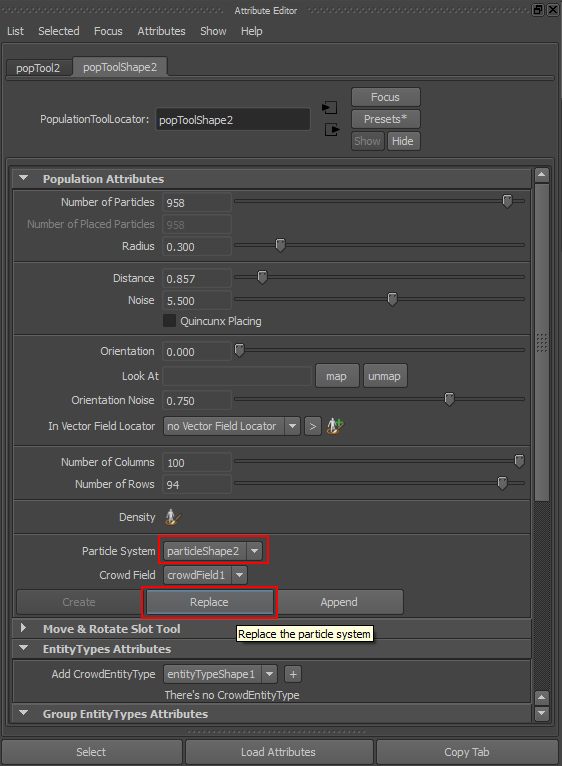

11. Add some noise in the placement and place your particles (this time linked to a new Crowd Field)
12. Your characters are now placed.

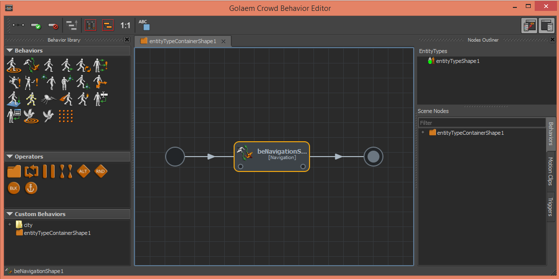

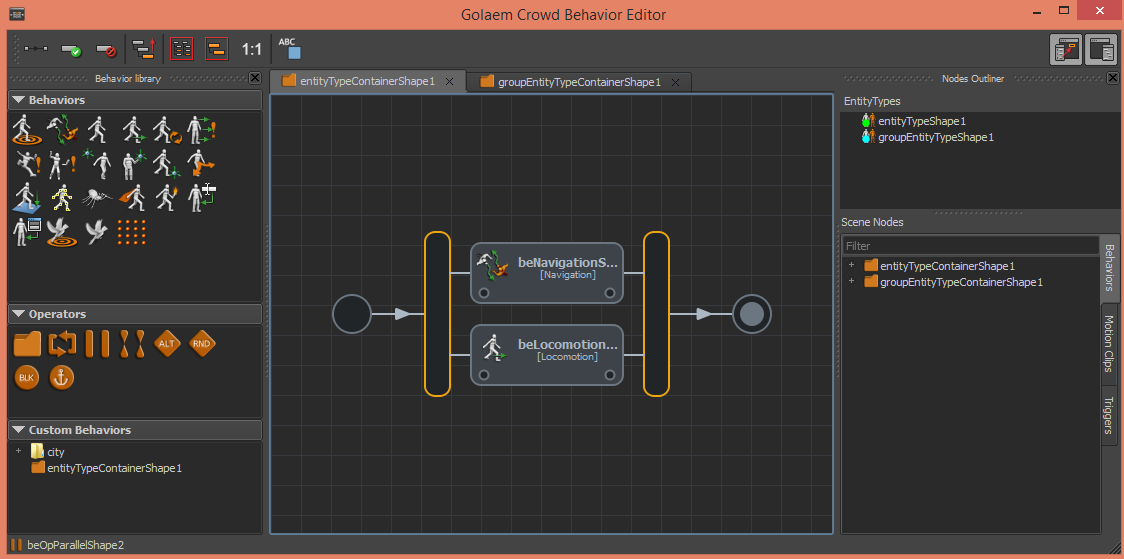

14. Now let’s add some moves to our crowds. Open the Behavior Editor
Select your EntityType and drag and drop a Navigation Behavior

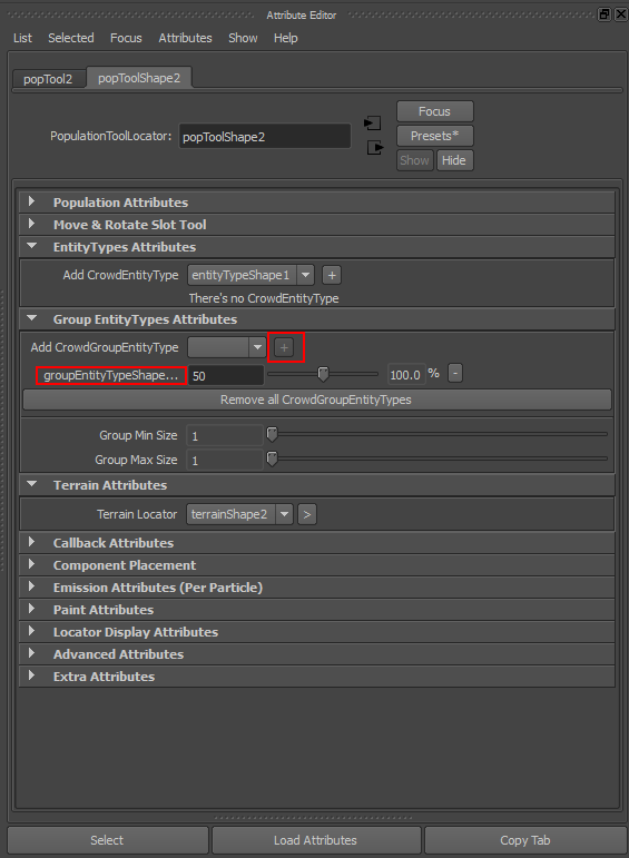

15. Click on the GroupEntityType icon
and go into your Population
Tool attribute to add the GroupEntityType to this Population Tool. It
means that the characters placed by this Population Tool will be part of
this Group and influenced by its behaviors
16. Make sure to select the particle system corresponding to your Golaem Crowd characters as the output particle system, and then click Replace

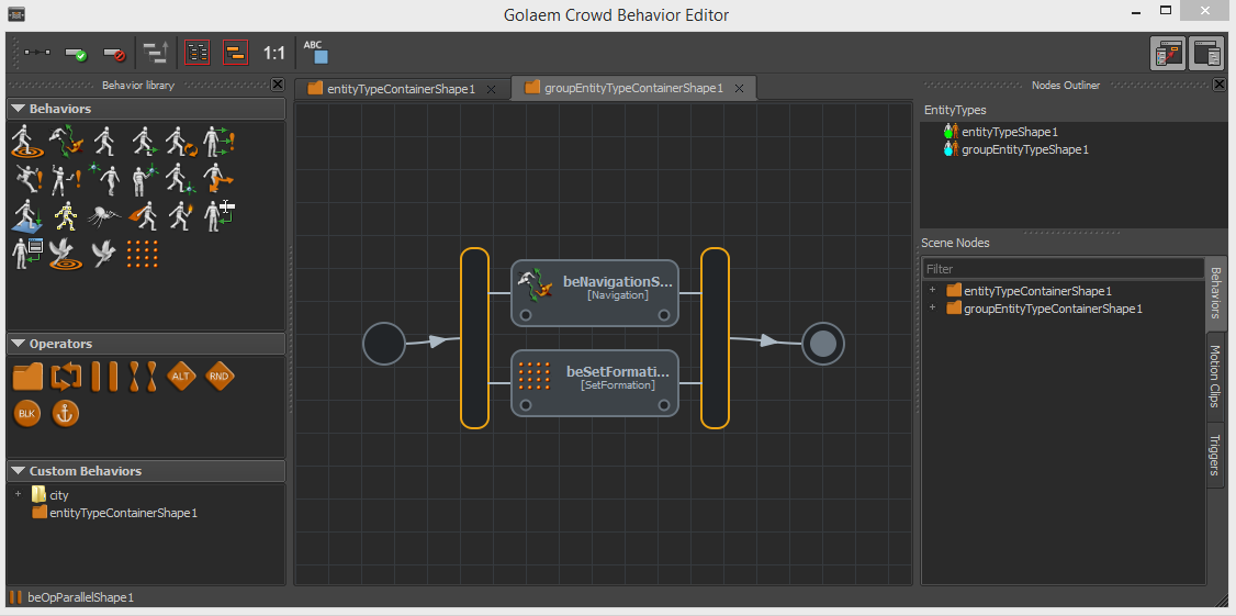

17. Back into the Behavior Editor, double click on the GroupEntityType
to open its behavior container and drag and drop a Navigation Behavior.
Then drag and drop a SetFormation behavior
on top of it to get them in a
parallel operator.

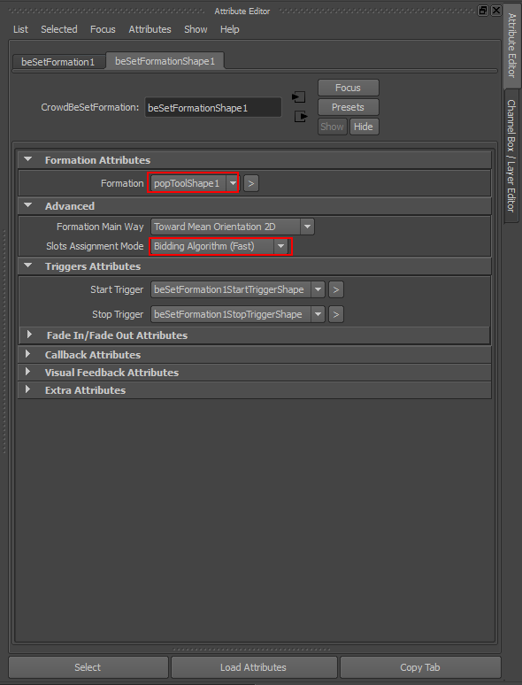

18. In the SetFormation behavior, map the goal Population Tool and select the Biding Algorithm (Fast) as the assignment model.

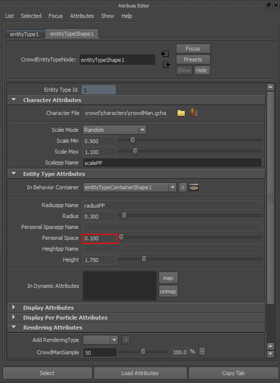

19. To get less repulsion between your entities decrease their Personal Space from the EntityType attributes

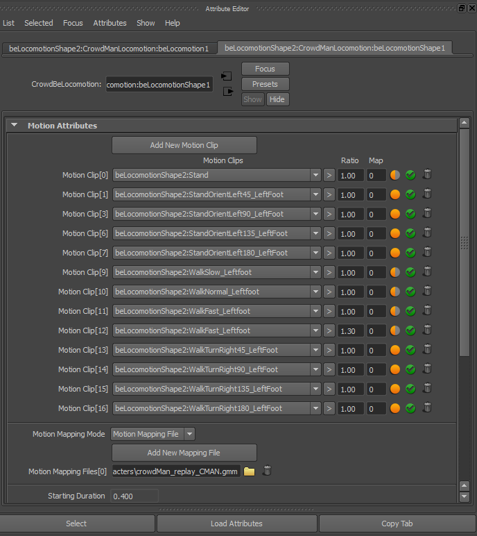

21. Now to give some natural moves to your crowds go back in the Behavior Editor, open the EntityType (not the group one) and add a locomotion behavior and its motions (or drag and drop a previously save Locomotion Behavior template) in parallel to the navigation.
22. Play again your simulation.
