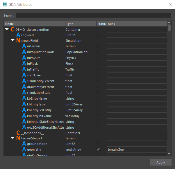

GDA Attributes Window
The GDA Attributes window lets you:
- set which GDA Attributes are made public, thus available for other DCCs running the Golaem Engine. Public GDA Attributes can be overridden in these DCCs.
- set GDA Attribute aliases which can be used instead of the real GDA Attribute names in other DCCs running the Golaem Engine for better readability or shorter names
The GDA Attributes window lists all the nodes of the GDA file to export, along with their attributes and types in a tree view.
GDA Properties
| Name | Name of the GDA Node ( ), Container ( ) or Attribute ( ). |
| Type | Type of the GDA Node, Container or Attribute. |
| Public | When checked, the GDA Attribute is set public. |
| Alias | Alternative name for a GDA Attribute. |
Public attributes and aliases are saved within the Maya scene on the Crowd Manager Node.
Search bar
The search bar lets you search for any node or attribute by name, type or alias or public attributes with the public keyword.
