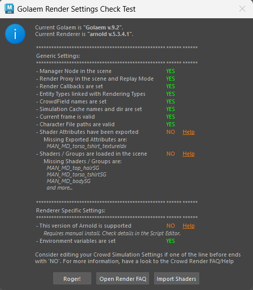

Check Render Settings
The Check Render Settings Tool lets you check, before rendering, that all the required elements to render a crowd are correctly set. It takes into account the current renderer and its specific settings as well.
Creation
- Golaem Shelf:
(when
in Cache Replay mode) - Crowd Render Menu: Check Render Settings
- MEL command: glmCrowdProxyToolCmd;
Tool Settings
If one of the Checker line ends with "NO", it means that the rendering will fail and thus it is recommended to edit the crowd scene settings accordingly. Each "NO" line comes with a Help link to the Reference Guide to help fixing the issue:

Shader Attributes have been exported
Shaders can sometime be controlled by attributes from your simulation. These attributes values need to be exported with your simulation cache. If you get a NO here it means some needed attributes are not found with your simulation cache
- Did you select all the attributes referenced by your shaders (see CharacterMaker / Geometry tab) when exporting your simulation?
Shaders / Groups are loaded in the scene
As Golaem character file does not contain your character shaders, you need to import them in your scene before rendering.
- Did you import your characters shaders?
- Are the names exactly the same as in your character file Geometry Tab? (check namespaces too)
- Are they assigned to a geometry in your scene? (even if not visible from camera or no Primary visibility)
This version of your render is supported
If the rendering engine version line ends with "NO" with the sub line "Requires manual install", it means the rendering engine version is supported by this version of Golaem but must be manually installed. Please check the Script Editor and how to manually install an alternative version of the rendering plug-in here.
If the rendering engine version line ends with "NO" and no sub line, it means the rendering engine version is not supported by this version of Golaem. Please check the Release Notes to know which version are supported
