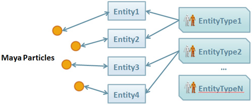

The following picture illustrates the relationship between Maya particles, Entities and EntityTypes:
Relationship between Maya Particles, Entities & Entity Types.

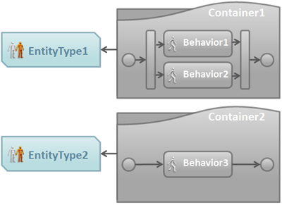

Behavior Container & Behavior
A Behavior Container is an object which encapsulates a graph of Behaviors. Each Entity Type defines its own Behavior Container: all the Behaviors added to an Entity Type Container will be affected to their corresponding Entities.
A Behavior is a built-in and atomic action which can be executed by an Entity (go to a target, play an animation, look at a target...). Behaviors belong to a Behavior Container and can be combined together to create a more advanced action and react appropriately to events. The following picture gives an overview of the Behaviors affected to the EntityTypes:
Behavior & Behavior Containers of the battle crowd scene.
The following picture illustrates the relationship between Behaviors, Behavior Containers and EntityTypes:
Relationship between Behaviors, Behavior Containers & Entity Types.
