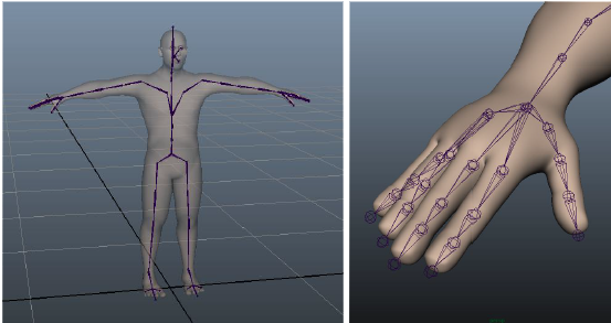

The following figure shows the recommended skeleton posture:
Recommended biped skeleton

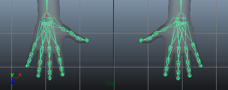

The amount of squash/stretch associated with a bone is computed considering the distance between this bone and its child. If a bone has several children, then all the distances from this bone to its children are taken into account to obtain a Squash’n Stretch average ratio. So the distances between a bone and its children must vary in the same way. For instance, if considering the hand of a human morphology (a hand bone with five finger bones):
Right hand not properly handled, as index finger is stretching whereas other fingers are squashing
